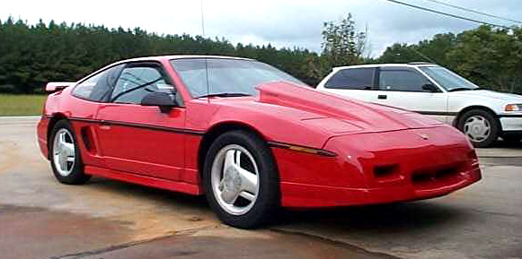

Don't know what year these are from, but I just bought set of 16" Sunfire rims a couple of weeks ago to use on one of my Fieros. No, they're not for sale.  (This isn't my Fiero, but this is what the rims look like on one.)

Those are 95-99 sunfire rims and they are NICE, think I like them better then my faves so far

Just be warned any stock sunfire wheels have a horrible offset to use on the Fiero.  They stick way too far inside the wheel wells.  You can come and look at Lisa's V8 with the Sunbird wheels on it.  Looks horrid.

So which is it Dave... Sunfire or Sunbird... or both?
Are you suggesting that the Sunfire rims on this Fiero look "horrid"?
(I had referred to these as Sunbird rims in my earlier post, since corrected.)

Could be a year thing.  Both the sunbird and sunfire have been around for decades, so it's quite possible the offset changed over time.
edit: oh yeah - the rims on Lisas car are REALLY inset.
But most of you have seen the rims on my 86/7/8 car (the 7 spoke silver ones) -- those came off of an unknown year cavalier (aka sunfire) and they fit great!

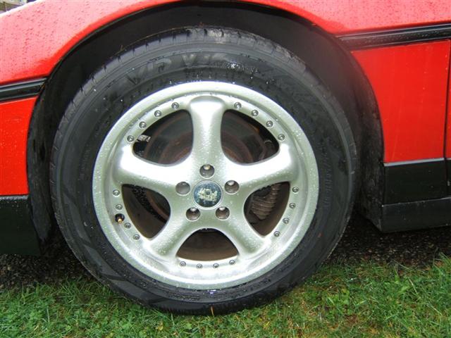

Sorry, you are looking at the early V8 pics, those wheels are now on her V6.  Her original V6 wheels are now on her V8, but here they are on her V6.  From this angle they don't look too bad, however if you look on a side profile you can see how tucked in they are.
Post Options Post Options   Quote Capt Fiero Quote  Post ReplyReply Direct Link To This Post Posted: 04 January 2010 at 12:44pm
Oh and they are Cavilier wheels which as far as I know are the same as Sunfire.

K total n00b question but would wheel spacers help with the offset? Really like Patrick's and the Capt's (there was a set of those on Craigslist BTW)
ie http://www.performancealloys.com/alloy_wheel_spacers.asp

Oh - and on the wheel spacers...
They would in theory work to make things look normal - but they are VERY hard on your wheel bearings.  I just replaced a pair of rears on a guys Lambo replica due to them.  And that car only got driven about 500 miles a year.
