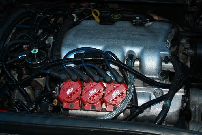

So i bot new MSD coils wires and E3 plugs for the fiero.Put the MSD coils in and started it and went for a ride to make sure it run,then do the plugs and wires.But my new alternator i bot 6 months ago was way over charging almost 18 volts.So off to lordo and get a exchange,changed the new alternator and all go 14.74 volts at the gauge and at the battery.know i can do the plugs and wires.Heres a pic of the coils only.

Looks good.
Will it make it out to the meeting this weekend? |

Thats the plan i hope.
