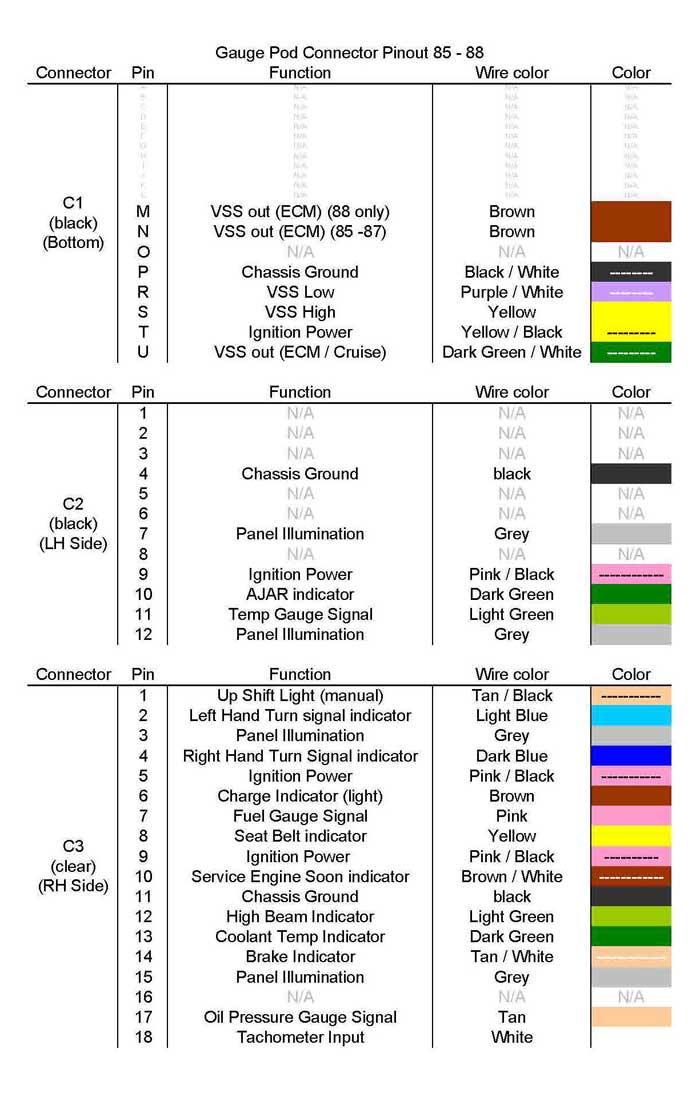

Man this was easy. Time consuming but easy.
Pull all the bolts for the cluster to gain easy access to the clear connector on the right hand side. All 4 wires you need are there. 4 T-Taps and 4 male spade connectors then mount the tach and you are done. I stole this from PFF. ![]() All the wires you need are on C3- No not all PINK wires are switched power - Yes the Pink Black on pin 5 or pin 9 of C3 are switched power. The Sub box was thanks to Fire451 the head unit was Fry's Electronics, the Amp was EBay, 4500w, and the sub was Parts Express online. The tach I got from a (believe it or not) A baby swap forum that Lisa is on for 40 bucks and it works perfect. The box needs to go in another inch, but I am damn near going to need a porta power to push it in. I also need to replace the temporary 7mm screws that I used with some nice black screws as well as put some sort of grill over it. I also got my new monster tach installed yesterday. Too bad these parts are only temporary as all of it will be moved into my V8 when its done. ![]() ![]() ![]() ![]() ------------------ 857GT Part 85GT Part 87GT Part Caddy, 93 Eldorado 4.9, 5spd Dual O2 Custom Chip, Custom Exhaust. MSD Everything Now with Nitrous. Capt Fiero --- My Over View Cadero Pics Yellow 88GT 5spd Full Poly Suspension, Lowered 1/2" in front, Corner Carver. |
