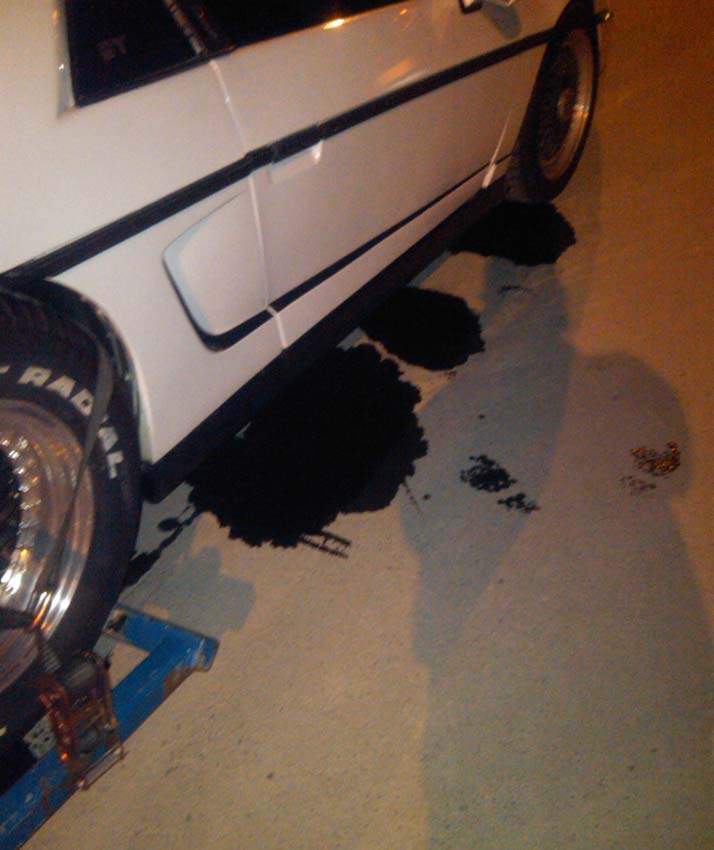

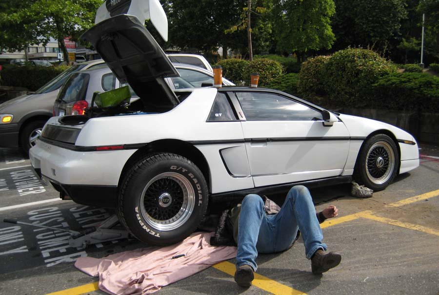

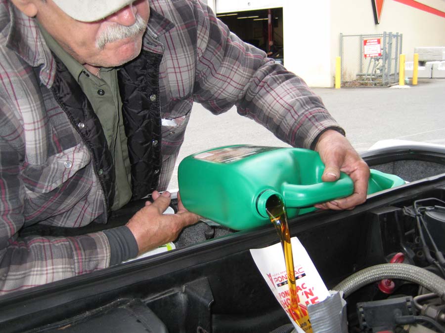

After the meeting was over Clynt gave me a ride back and just before the Port Mann Clynt said "hey Johnny there's NO OIL pressure on the gauge" and then our man Clynt said "must be a faulty gauge"! A few minutes after that we heard a ticking sound so we drove for a just a bit longer and the ticking noise got louder so Clynt pulled off onto an exit and we stopped and there was a pool of OIL on the ground. So Clynt checked the dip stick and it READ empty. ![]() for parking on the highway in the middle of the night. So the tow truck came and took us to the Canadian Tire at King George/138th/104th. We have phoned Gina and she came with her sister for the rescue and drove us to RBS place where the van was. Clynt and I packed up the van with a jack, tools and rags ready to go to the Canadian Tire in the morning to see if we could fix it. ![]() Here I am freezing and going into the tow truck to get warm ![]() ![]() This is Sunday morning and we are at Canadian with the jack and tools and there is Clynt to see what can be done. He found the problem was the oil cooler line slipped loose and spilled all the oil OUT. Clynt just tightened the hose back in and it was fixed ![]() Clynt is walking with TWO jugs of oil ![]() Clynt has made his own funnel from the All Pontiac Show PROGRAM and duck tape for the spout! ![]() To make matters worse, Clynt somewhere along the line from the Club to the Port Mann also lost his driver side SAIL Panel. ![]() ![]() Clynt drove home to clean the chopper up ![]() THE END |

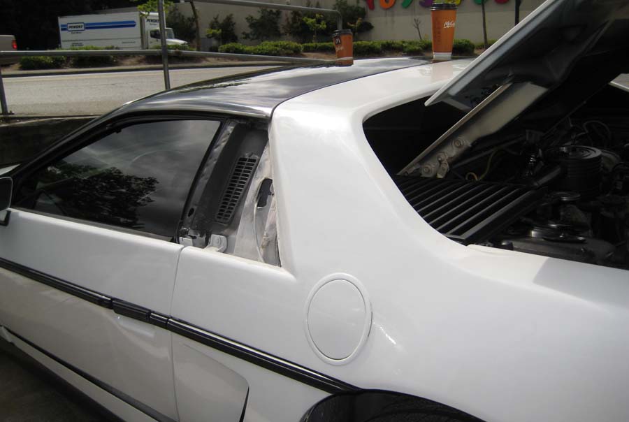

Bah, you feign shyness. Secretly, you love the title. Sorry to hear about the car though, Clynt and Johnny. I suppose it's nice that nothing was damaged too severely, beyond the sail panel. |

I also lost a SAIL panel a couple of months ago. Turned
out the car was placed backwards on a flat bed tow truck (the front of the car at the back end of the flat bed) and when the truck went down the highway at about 100 KPH, the wind pressure got under the back of the sail panel and tore it off! ![]() PS: I always need a flatbed truck when I tow my car. The front of my car has only about 1/2 inch of clearance if the driver tries to use a normal tow truck (lifting from the back)! |
