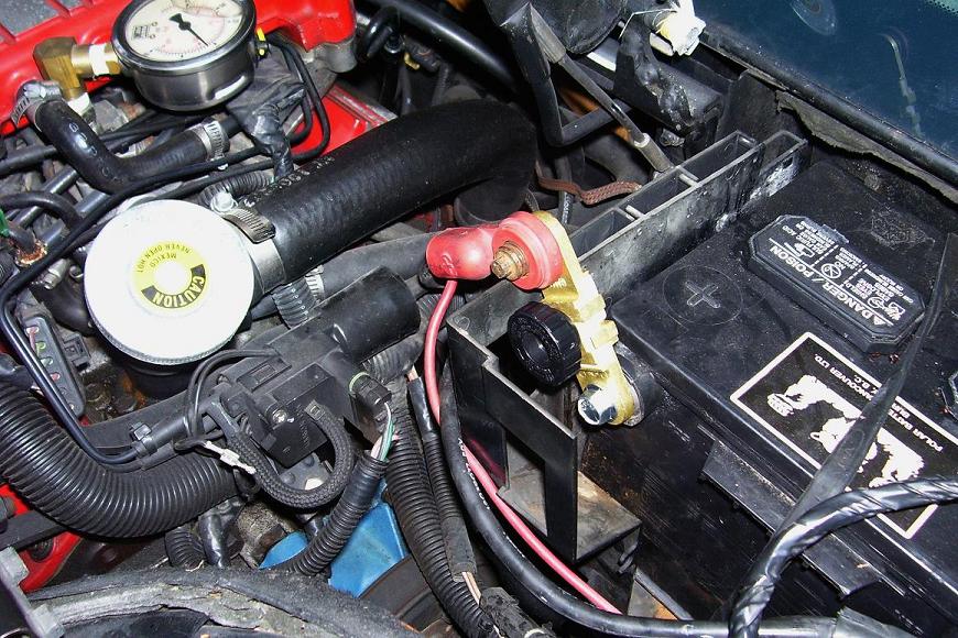

To save me from stripping my battery terminal screws and the thread in the battery, I bought a cut-off switch.  I bought it from Fierostore, but also found it on ebay for...more.  Lordco stocks the version for the top posts but not the sidepost batteries.
After mounting it neatly, I found there wasn't enough room to thread the positive cable between the engine and battery box, so I had to route the switch over the battery box.  I'll have to work on that as it does look kind of messy.  So when I store the car, I just have to give the knob a quarter turn and the battery is disconnected.  A clean and safe way as I was always aware of the possibility of zapping myself good connecting and disconnecting the battery all the time.

Ken does it just twist and turns off, or do you have to unthread it all the way and the joint comes apart.  Just curious.  It it just twists and shuts off like a switch I might buy a couple like that.
Post Options Post Options   Quote beken Quote  Post ReplyReply Direct Link To This Post Posted: 04 June 2007 at 1:30pm
Actually, it's a pretty clever design.  The bottom of the knob is a metal plate.  It is that metal plate the makes the connection between the top plate and the bottom one.  So it only takes a quarter turn to connect or disconnect the battery.  Nothing else actually comes off.  Race cars which do not have a proper t-handled battery disconnect use these as emergency can just twist the knob and the electricals are killed.
