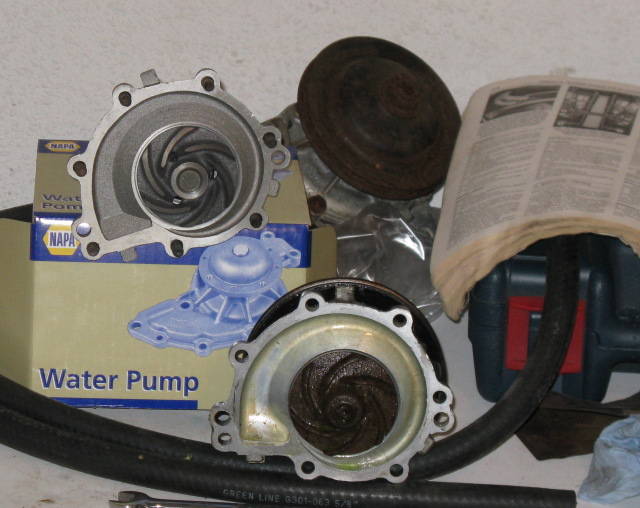

I don't know about part numbers, but I recently had to buy a water pump for my 86 duke. I got a metal one from the Napa in Abbotsford. I've read online that you should try to get one with a closed impeller, however I believe the one I got is an open impeller. I haven't had any issues with it, though. I took a picture of it compared to my old one, I'll upload it, the new one is shown sitting on top of the box it came in.
To move the pulley over I used a power steering pump pulley remover and installer tool. Like this one:

Geez, I've never even seen one of those types of pullers before. Hopefully one of the club members closer to Vancouver has one and can swap pulleys for me.
I also wasn't aware that there were differences as to whether the impeller was open or closed.

I wasn't aware that they made them with plastic impellers, that sounds a little scary. At least you'll be able to change it while the cradle's out, there's not much clearance to get at the bolts while its in the car. I had to change right after putting the cradle back in and discovering that it was leaking, that was frustrating.

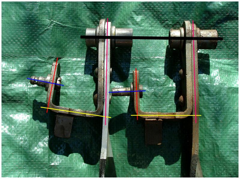

Dave, I appreciate the offer (and I'll probably take you up on it!), but did you have a good look at those pictures in This thread? I don't believe there's enough room for the clutch fork to pivot before the clutch release lever would hit the bellhousing on the gimped '84. For the clutch release lever/fork shaft to already be that far rotated, I believe the fork must be positioned beyond where it's supposed to be.
In regards to the hydraulics, nothing would happen when the pedal is pressed if the clutch fork is jammed someplace it's not supposed to be. I'm pretty sure this is what bent up the pedal so bad. I suspect the previous owner must've been standing on the pedal trying to get it to move!
Here's the '84 pedal I took out compared to the one from my '87 I'm "borrowing" to put in the '84.
