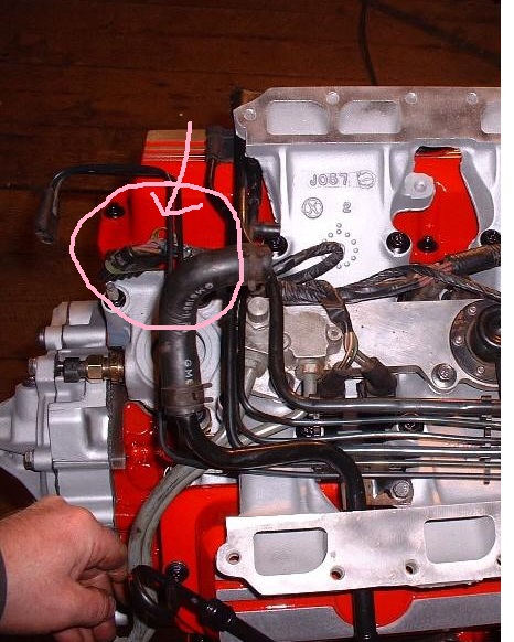

Thankyou so much ccaptain. Turned out.. It was my fuse for the fuel injection.. But it keeps blowing.. Now I was looking into this... http://www.fiero.nl/forum/Forum2/HTML/124585.html That's is what I'm. Having now.. I am. Shorting out somewhere but how could or where could be... Also. I mentioned I have a leak between the. Inner exhaust manifold and downpipe. Rusted out.. The gasket is gone from there... Could this be a related issue |
Post Options Quote Reply Posted: 02 April 2013 at 8:01pm |
Well I am glad it was just a fuse for one of the banks. 1st things first unplug the injector harness its a large flat connector near the dogbone mount. Then re-insert the fuse and see if it blows. Obviously you can't start it, but you can try and crank it over. If the fuse does not blow then you need to look at the injector side of the harness. If it does blow then you need to look at the engine side of the harness. There are several places where the injector harness comes in contact with engine mounts and such make sure that it has not rubbed through the insulation. I had a similar issue where I was blowing a bank fuse on my V8 and turned out it was just bit of the harness had been rubbing, cost me about 20 cents worth of tape to fix it and never had the issue again. As to the exhaust leak, I doubt it would have anything to do with it, unless it was blowing exhaust gas right onto the harness and the harness is not in that area.
Again glad it was a simple fix. Now just find the short and away you go. |

I can't seem to find these locations. Is it possible u can show me a
picture |
karnak
Senior Member Joined: 28 August 2009 Location: Canada Status: Offline Points: 349 |
Post Options Quote Reply Posted: 05 April 2013 at 4:51pm |
Circled |

Is that the 2.8 v6
Dr.Fiero
Post Options Quote Reply Posted: 05 April 2013 at 6:28pm |
Yes - it's a 2.8. That's also MY hand! I've been recycled! Well, my photo has been anyhow. :)
