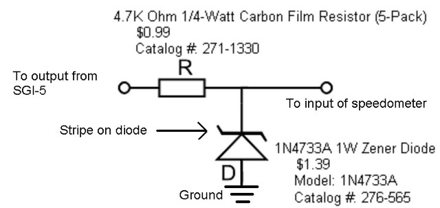

For the speedo, there's a simple circuit to wire up between the digital
vss and the Fiero speedo that will get it all to play nice. I had to do it for
my trans swaps, costs about 3$ for components and takes 5 minutes to
make.
I can find a diagram when I get home but it's easily googled. And on
gmtuners site.

I forgot the f40s output a different signal then the f23 and 4t60s do. The
gmtuners circuit won't work then.
