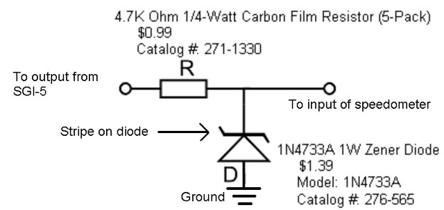

For the speedo, there's a simple circuit to wire up between the digital
vss and the Fiero speedo that will get it all to play nice. I had to do it for my trans swaps, costs about 3$ for components and takes 5 minutes to make. I can find a diagram when I get home but it's easily googled. And on gmtuners site. |

I forgot the f40s output a different signal then the f23 and 4t60s do. The
gmtuners circuit won't work then. And if your going through the effort of the f40 swap, why not replace the engine while your at it? |
