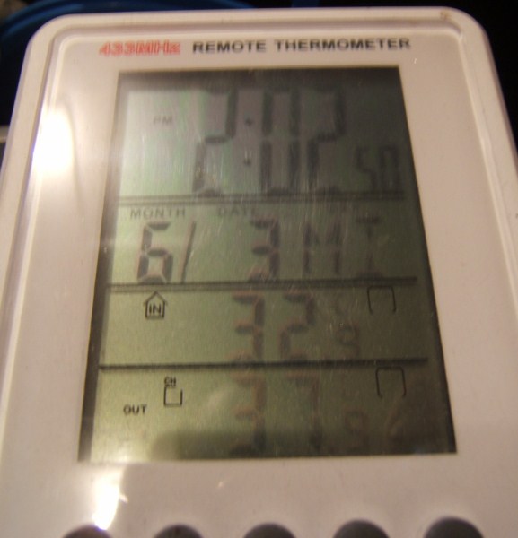

Holy CRAP its HOT.
Yesterday in the shade at 2pm it was 37.5C   Its just after 12 now, and its already at 33.8  I guess its just because we are at the top of Johnson Hill we are in a little weather pocket all our own.  Tristen when you come over today, bring lots of fluids.
Its 33 here now in the shade.   The top number is the inside temp, thats inside my garage with all the doors open and fans running.  The outside temp is a remote thermostat under a white picnic table next to the house outside.
