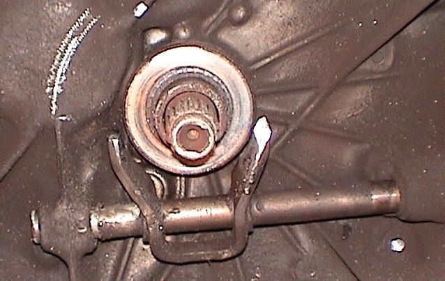

Anyway, I needed to drop the cradle and Clynt has been kind enough to let me use the hoist at his place. He also offers advice as required.  So we got the tranny off today and discovered that the clutch fork is toast. Very very similar to what Dave reported finding when he took a look at Nigel's Fiero as reported Here.

Wrecked clutch fork with the broken piece sitting at the bottom.

I need to now pull off the pressure plate and inspect the condition of the clutch. If anyone can see in these pictures why the clutch fork might've broken the way it did, please let me know.

It sure looks like the throwout bearing was rubbing on the pressure plate fingers.  This means it was not spinning nicely.  Over time, this would cause the fork to erode away.
Seems like a common problem eh?

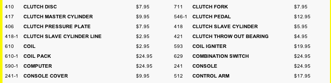

theres 2-84/85 @ pickaprt in Chilliwack.motors/trany are still complt,both
with 4 speeds,CLUTCH FORK      $7.95
http://www.pickapart.ca/price_list.php
hope this helps

If anyone has this problem again (Like I did), I found I could reinforce the clutch fork by welding in triangular shaped pieces between the horizontal and vertical pieces of the fork...in my case it was the horizontal to vertical joint which failed (This is the stressed area).
