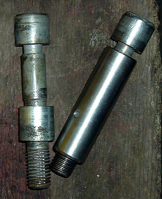

I wanted to pull the front calipers off because it felt to me like the front brakes were "dragging" a lot more than they should. I couldn't believe my eyes when I removed the slider bolts and pulled the calipers off the car.
Instead of the proper 2"(?) slider sleeves stuck in the caliper slider holes, there were these short 1/2" sleeves stuck in the holes towards the rotor end of the bolts. There was nothing at the head of the slider bolts to seal against the internal O-ring. Not only that, but because there was no sleeve at all in most of the bore, the caliper obviously wasn't being supported properly by the bolts or sliding properly on the sliders.
The picture below shows a proper bolt/slider sleeve on the right, and on the left is one of the bolts/slider sleeves I found in the front of the '84 I'm working on.
Am I being too harsh to suggest that whomever installed these short slider "sleeves" is a total idiot?

yikes remind me not to let you do my brakes lol jk:)
yeah im sure whoever did them ..made a mistake ??? lol
imagine what went through is head .." damn lost the parts ...um these will work ..yeah ..they will work .."
Post Options Post Options   Quote Bassman Quote  Post ReplyReply Direct Link To This Post Posted: 25 January 2010 at 8:22pm
OMG...
Post Options Post Options   Quote Capt Fiero Quote  Post ReplyReply Direct Link To This Post Posted: 25 January 2010 at 8:31pm
That car should not have been on the road with brakes like that.  f**king idiots.  Patrick I would start going through everything that is "safety" related and also carry a fire extinguisher in the car at all times.  Its an 84 after all, so wiring is hard to get replacement parts, who knows what the hell the previous owner did to the car.  I'd be very careful if I was you.
        Sounds like you are making that a really nice car.  So I would be extra careful to make sure nothing happens to it, or worse to you, while driving it.
Fortunately, except for driving it from Clynt's place to mine after the tranny swap (slow ten minute drive in town), I haven't been driving this car. It's been sitting in my driveway as I continue to weed out various issues.

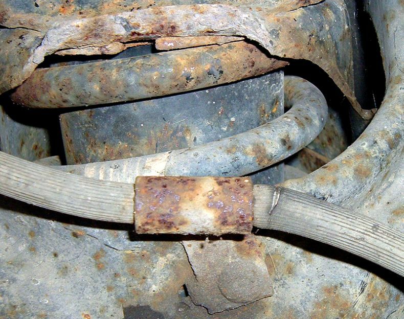

Today I was taking the driver's side caliper off. It didn't take long to see that a replacement hose was going to be required as this one is split. It wasn't leaking, but I guess it's just a matter of time before the inner layer lets go.
And now, yet another bonehead move by whomever worked on this car prior to me buying it. I noticed the mounting bolt on the bottom of the driver side front shock was "different". It also didn't have a self-locking nut like it's supposed to. I thought I better investigate. I removed the bolt and pulled the shock away from where it mounts, and again, I couldn't believe it. The inner metal sleeve is gone, and the rubber is all chewed up from riding directly against the sharp threads of the bolt.
What kind of retard does these things?

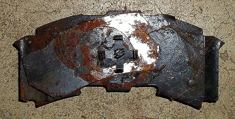

A couple of questions for those of you who know more than me about brakes - I was a little puzzled when I looked at the backside of this inner shoe. It looks like a shim has gone way off center. What's supposed to hold it in place? I can't swear there even was one on the passenger side. If there is one on the passenger side, it must've been centered properly as I never noticed it. If it wasn't there, is it necessary?
Post Options Post Options   Quote Dr.Fiero Quote  Post ReplyReply Direct Link To This Post Posted: 26 January 2010 at 8:30pm
It's really just an anti squeel shim.  But...  it shouldn't be off center like that.  They're usually glued in place.
Oh, this one is glued in place all right. However, it's somehow shifted position.

           Patrick, I just keep shaking my head, I would go find the previous owner, then find his/her mechanic, and whack him upside his head several times.  Those type of people are the ones endangering all our lives putting cars on the road like that.
    Next up, I would race to your local auto place and buy several cans of Black Tremclad and just start spraying, spray everything around the shock towers, the spring perches and everything you can get your can at.  Hopefully you can slow the rust progression down and keep the car in one piece.
I've been thinking about what you said about the rust because it's actually not all that bad. Honest! I realize in retrospect that in the image above of the split brake hose, the metal in the picture looks awfully corroded. However, the big reason for that is that I always "enhance" my posted images with a boost in color saturation. This has made the appearance of the minor surface rust in the picture look much worse than it really is, plus the fact that I was zoomed in pretty tight and the flash shows off every little detail.
This '84 Fiero is far from "mint", but it's not a rust-bucket either as that image above may lead people to believe.
   I would have sworn that you were there, must have been another club event that I am thinking of.
        As for the rust in the pic, if it is not as bad as it looks, great, I think you are going to enjoy the car regardless.  There is just something nice to be said about driving a stick Fiero.   I had a slush box for years in my 85GT and it was like driving a whole new car when I converted to stick shift in it.
