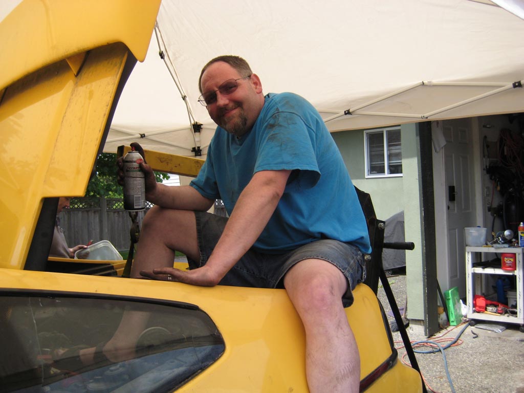

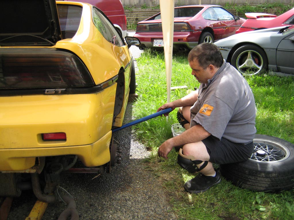

Will do photo's later, but we loaded his engine onto the trailer, after getting everything removed off of the cradle. (F&UCKING Inspection Plate) He took the motor to crackers, got it onto an engine stand, partially dismantled. Then got back here, we put the cradle / trans / suspension back into his car, got the wheels back on the car so it can be rolled. I got a battery back into my 88 fired it up and moved it into the staging area, then we realized that it was 4:30 and he was behind schedule to leave. So he just left, I am taking a break, then I'll get back at my 88 and see how far I can get before he comes over tomorrow morning.

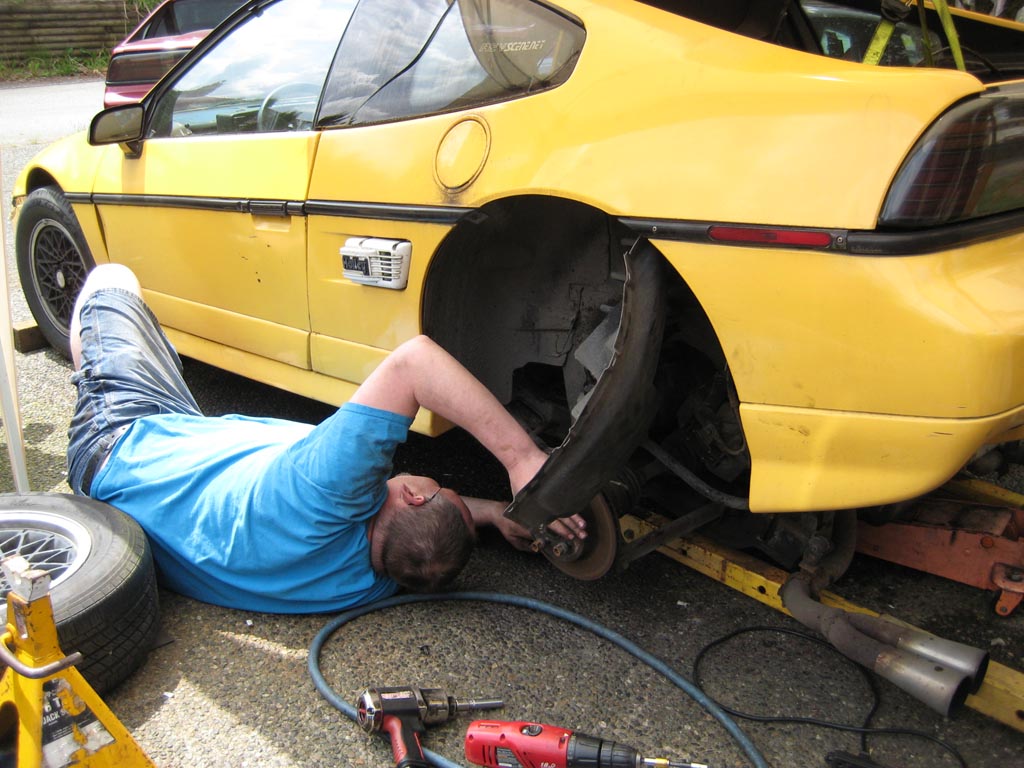

We got the motor out of the 88, then Damian ran to the locker and grabbed the engine stand, we put the spare motor on the stand to check it over, and everything looks great inside, still doing inspections. |
Todays Pics. I did them in gallery format becuase there were so many of them. Of special note, everything went smoothly until one of the damn cradle bolts spun forcing us to cut a hole in the frame rail.

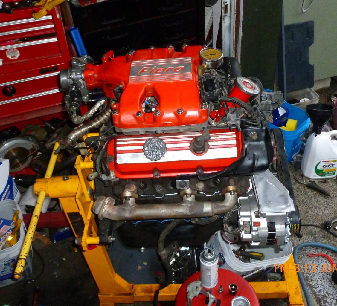

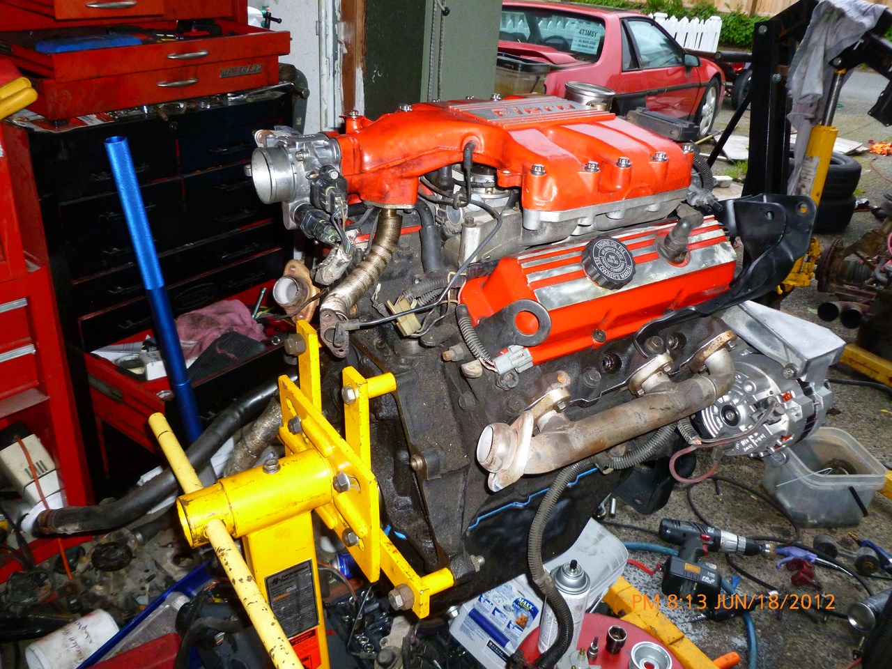

I have some 60+ photo's to post, but here is just one quick teaser shot. The A/C bracket needs to come off and get the same polish that I did to the Alternator bracket. Aside from that, what do you think so far.

I polished up all the brackets today, ran all the wiring and hooked up the sensors, installed the adjustable fuel pressure regulator. (Something I think all V6 Fiero's should have especially ones that get driven hard) I did a ton of little things today and clear coated a lot of the polished pieces so they should stay shiny for a long time. I used my needle point greaser and greased the hell out of the throwout bearing so even being used, it should outlast the clutch. As for install, if everything goes as planned, I'll be installing it this week. On a side note, I have actually found a source for Good Year Gator back belts. Yippee, I am so happy to be able to buy them again, I'll have one at the next meeting to show people why they are so good. Instead of just having straight ribs, they have teeth kinda like an aggressive car tire. So as it wraps around a pulley, the teeth open and close and bite into the pulley. I have never had a gator back belt slip or squeal or any other issue even on a rainy day with an engine that has a front main seal leaking oil. Lordco stopped carrying them a long time ago, Napa never had them, turns out that Alder Auto parts can get them. I have a new old stock Fiero V6 stock length belt here that I can't use, because I run the under drive kit on my car, so I'll be either selling it to someone or donating it to the club for the raffle. P.S. Gary, I have decided to get rid of all 3 of my tool boxes. When I am done with both of these engine swaps, am going to sort out the tools and give you first option on buying one before I repost on Craigslist. |
