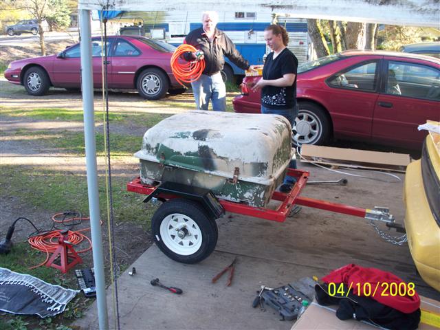

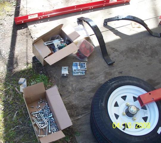

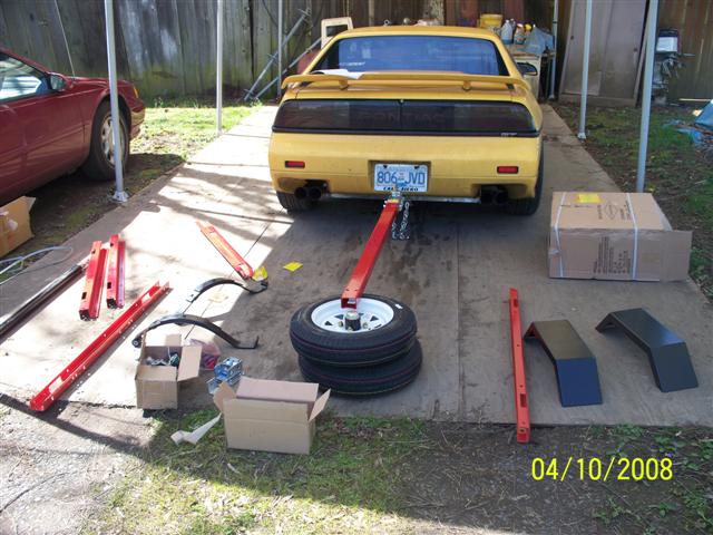

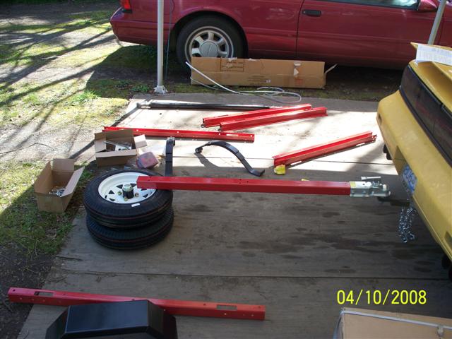

OK I am going to link this thread to the club BC Trailer thread. I thought I would post up a couple quick pics.
We went down to Harbor Freight and picked up the trailer today. I was impressed to find out that when you bought it, they had brand new Oregon title/registration forms right there included when you paid for it. I think it is still classed as a U-Built, as it is stamped in bold righting that it IS NOT BE SOLD Assembled. So we loaded the boxes of parts into the trunk of a Thunderbird and brought it to my dads house. My father is a tool nut, so he had a stack of tools and impact guns that Lisa and I used to put it together. It took about 2hrs to assemble from start to finish. The load rating on it is a bit confusing. I am assuming that we simply use the lowest stamped rating. However the toung trailer is stamped on the frame rated for 1250lbs, the axle says 1350lbs, the tires and the tongue are stamped max of 2000lbs. It says on the wheel speed limited to 55mph. (about 90kph) However I am assuming that it should be fine to run 110kph with a moderate load. (heck not that I am going to try it but looks like it would be fine for sustained speeds well above that) It comes with DOT legal lights and wiring included. The deck sits low enough that I should be fine running it without the extra lights wired up. With the type of the frame, I am really thinking a set of notchback taillights would work really well on the back of it. Instead of the stock trailer lights it comes with. Well enough chatter here are the pics. |
