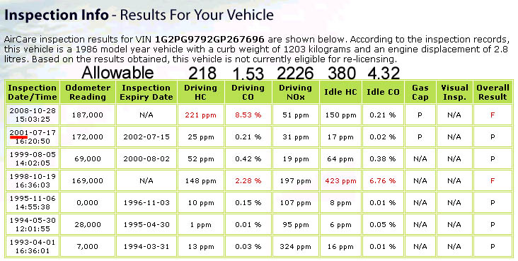

I had originally started to post about this in another thread, but I felt it needed it’s own home. So I’ve transferred over my posts as well as Dave’s responses. ********************************************** ... I failed AirCare miserably. I’m not suggesting it’s the deletion of the EGR or the custom chip, but something is amiss. The GT failed in two categories. I was rather shocked to see how bad the Driving CO was. Although I had installed a 180 thermostat before I had my custom chip burned, I put the 195 thermostat back in just for AirCare. New ACDelco O2 sensor, and the ignition system is basically all new as well (except for the wires) - ACDelco ignition module, pickup coil, MSD Blaster coil, Accel distributor cap and rotor, NGK UR5 plugs gapped to .060" and the timing was set at 10 BTDC with the A and B terminals jumpered. Motor appears to run fine, idles smooth at 800-850 RPM. Possible lack of power though from mid to high RPM. Here's my readings. I've added the Allowable readings to the image at the top of the columns. Notice the last time it's been through AirCare! (The car was in storage for six years.) Edited by Patrick |

Thanks for the feedback, Dave. Addressing your points: 1) The timing is currently set at 10 BTDC, set with the A and B terminals jumpered. 2) Yes, I was pretty surprised myself that the NOX readings were that low, especially with the EGR deleted. 3) Not sure why you suggest raising the idle speed as the idle readings are both fine. 4) With the car having sat for six years, I was wondering if perhaps the old gas had gummed up the injectors. I guess a fuel pressure leak-down test would show if one or more of the injectors are leaking (although I would think a leaking injector would also mess up the idle readings which are fine). 5) Just so it's known, the coolant temperature (as shown by WinALDL) was 220 before I entered the AirCare facility. I can't say I've been very happy with the gas mileage the GT is getting. It would be great if correcting the problem this engine appears to have would also improve its fuel economy. Edited by Patrick |

Dave, the O2 sensor is a brand new ACDelco unit. Bumping the timing up may help, but I have my doubts that an extra 2 degrees is going to make much of a dent in the Driving CO readings which are almost 6 times the maximum allowable limit. I have WinALDL and know how to use it, but I don't really know what to be looking for. Is anybody familiar enough with it that I could send a WinALDL log to be looked at? I'm hoping something would jump out at someone who is familar with WinALDL readings. Edited by Patrick |

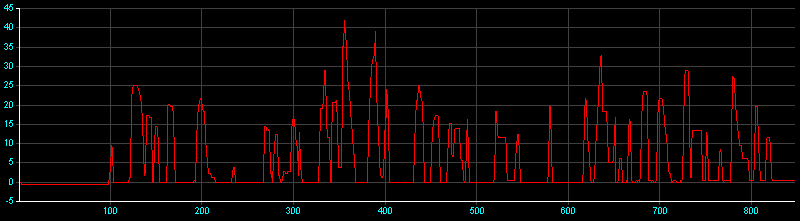

For anyone who might be interested in having a peek, this is a WinALDL datalog from last week. It was taken before I cooked my ignition module and re-did basically my entire ignition system. However, the car was running fine and I don't think the readings would be a whole lot different than what they would be now. The file is downloadable from Here. If I go out today in the GT, I'll save another datalog file. John, is there a chance that there's a problem with this custom PROM and/or it's somehow contributing to the excessive readings? Edited by Patrick |

Okay, I've got an up to date WinALDL datalog from last night ready for download. I'm really hoping someone (John, pretty please! ) can have a look at this and perhaps spot something obvious that might help to rectify my GT's AirCare failure. The file can be downloaded from Here. Thanks. Edited by Patrick |

I'd need to run it on another to compare, but....
Unless you were REALLY babying it on that run - I'd say you might have TPS issues. There's very little change in value over the entire chart. Remember to ignore most things until about the 700 second mark when you're up to temperature. |

John, I was babying it to some degree because it's sucking back gas incredibly fast. I filled it up (again) tonight and reset the odometer so I can work out the mileage this time. I also can't emphasize how gutless the GT is once the revs go up. It starts fine, runs smooth, and responds okay off the line, but there's no power if I rev it over, say 3000 RPM. When I kick it down into second gear on the freeway while doing 50-60 mph, all that happens basically is more intake noise. Looking at the graph with the TPS values, I'd say that's about how I was actually using the throttle. Being an automatic, it's not like I'm changing the throttle position a lot, as of course I'm not shifting (manually) while accelerating. I'm just pressing the throttle down to a certain point and letting off on it when I have to stop at the next light. For anyone who isn't familiar with WinALDL and ALDLView, here's what the Throttle Position Sensor data looks like for a short 25 minute or so drive within the city. Time is along the bottom, but I somehow doubt that each increment is actually one second. I've heard that a snapshot of data is taken every 1.8(?) seconds by WinALDL, so perhaps that is the actual increment. Edited by Patrick |

I imported the log to excel and graphed some of the results.
You never went over 35km/h and it doesn't look like you throttled up to get there, the acceleration having taken place over 10 seconds or so. This explains the lack of TPS movement. Please confirm this. Looking at the number of crosscounts and the fact the 02 sensor is recording full voltage swings seems to indicate it is working. Also, the INT/BLMs look to be around 128/120 for the short periods you were off idle. This indicates that the engine is generally rich and is trying to lean out (128 is the neutral). The INT at 128 means that the ECM is being generally successful in the short term with a BLM of 120. However, if the mass density of the air were to go down (I.E.: Warm day, reduced airflow in engine compartment), then the INT/BLMs would have to reduce fuel some more. If I remember right 120 is the mimimum the ecm will allow the blm to move to unless it has been modified (To stop a bad 02 from brutally leaning out the engine). This means that the excess fuel may be outside the ecm's ability to correct for. If this is one cylinder (Stuck injector) that might explain all of your issues. Comments/corrections??? Chay |

FYI, the data looks exactly the same on the excel file I made. The seconds formatting is correct, it just draws a line between data points to fill in the gaps.
I'm going back on my injector theory. It doesn't make sense that it would idle ok, although it could be a 'sticking' injector, rather than a stuck one. The other way to get a rich engine is an air blockage... Innie: air filter/intake valve not operating fully or not at all(rocker etc) Outtie: CAT, blocked muffler, or above with exhaust valve Chay |

You’re spot on about not throttling up much. It was rush hour traffic in Vancouver. One correction though is that the readings are in mph. ALDLView indicates that the highest value for Speed is 37. Whether it was 35 or 37, either figure is certainly in the ballpark.

The reason I think the increments are not a second apiece is because it seems to me that 800 seconds is too short a time to get to my Dad’s place by Metrotown from my place around Nanaimo and Hastings in rush hour traffic. That’s only 13 minutes! I’ll have to pay attention to the elapsed time next trip. Also, in my datalog it shows the engine going into closed loop operation at the 75th incremental point. Is it even possible for an engine to go into closed loop operation in one minute and 15 seconds from a cold start on a 55 F degree day (with it just idling at 1000 RPM)?
