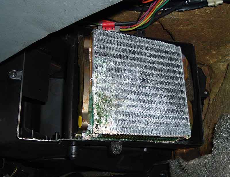

If your Fiero has A/C, then the following picture of mine (which I posted in JazzMan's thread) clearly shows where the four screw holes are located. (Basically in the middle of the two sides and the bottom, whereas the top one is above the middle of the heater core itself.)
This is looking straight across at the heater core from under the dash.
That top screw isn't all that difficult to deal with from the top once the passenger side dash speaker is removed.
