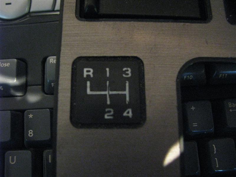

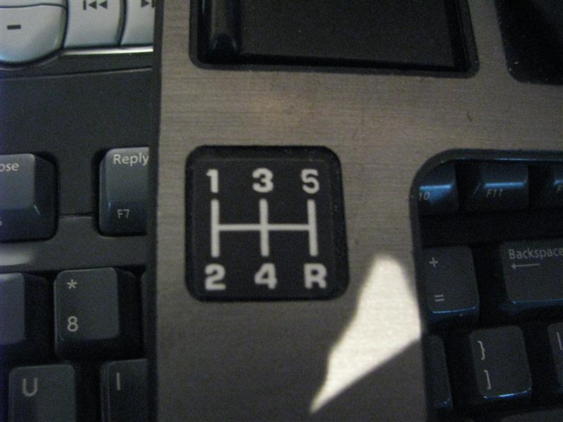

Post Options Post Options   Quote Dr.Fiero Quote  Post ReplyReply Direct Link To This Post Posted: 25 January 2010 at 10:11am
It worked!  Check it out...
Scruffy OEM one.
Revamped one.
(it's actually just sitting there, not stuck down BTW)
I'm not happy with the font of the "5", so I'll work that over and do it again - but once I got a system worked out, duplication is pretty easy.

Post Options Post Options   Quote Dr.Fiero Quote  Post ReplyReply Direct Link To This Post Posted: 25 January 2010 at 11:57am
Yeah, that 5 sucked in the original image, so...
I'm redoing all of the lettering, since it was a low DPI image to start with.  So far, I'm looking at a 58pt font of Ariel rounded MT bold.  It's pretty damn close.
It's a combination of 2 products right now - might kick in a 3rd (it ends up being 3 layers thick in other words!).
I'll post up more when I'm happy with the end result.
