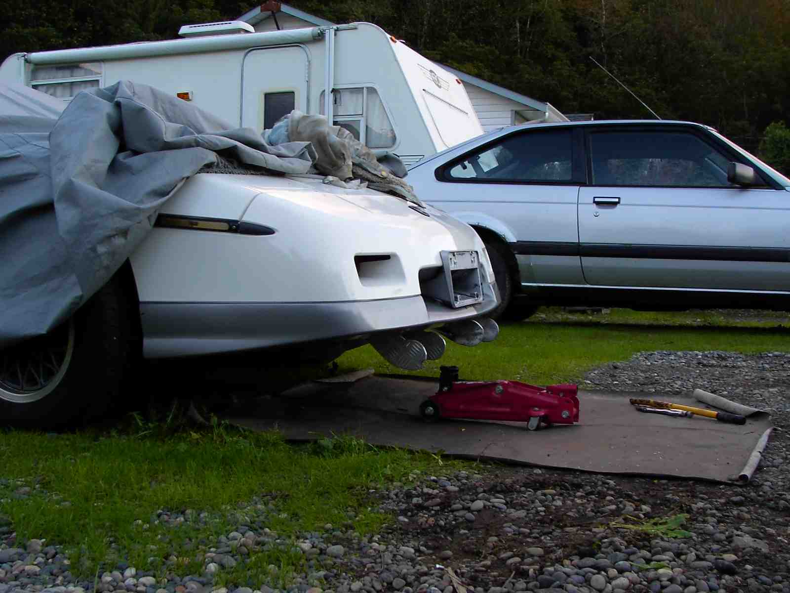

Got the news today i have to move my other Fiero/Black 86 auto.its only
about a mile away,but it is AUTO, no towing vary far.i don't have to far to
go.so 3 point hitch posable? took a peek under the front my White 87 an
there is a place for one,custom fab only!,has any one ever done this?ive got
a plan an will start build it this week.first one i build won't fold but if it
works out,i would like to make it so its folds up an fits in the car some were?
so you could tow your broken down buddy-LOL
THANKS

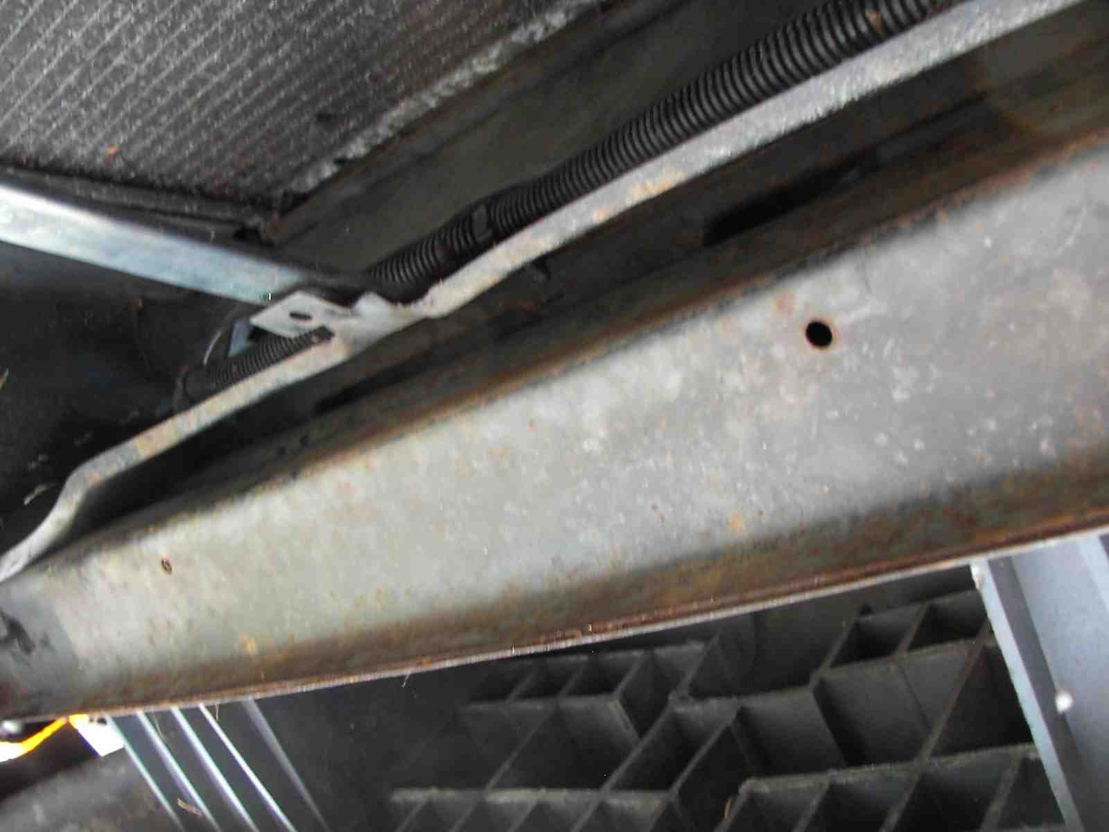

I do recall! looking at this post,thats why i think it can be done.a clamp type system that bolts up to the two holes in the
frame under the nose,rite where Patrick shows it in his post, with this type of hitch its is a 3 point.an the nose will
NOThave to come off.but on my 87GT it has two plastic blocks in the place where the holes are,thats showen in Patrick
post?are there diffrent frame front ends on Fieros,i thought they were all the same! any in put would be great,thanks guys

...but on my 87GT it has two plastic blocks in the place where the holes are,thats showen in Patrick post? are there diffrent frame front ends on Fieros,i thought they were all the same!
Those plastic blocks on your front end will unbolt from the metal plate they're attached to.
I suspect Fiero front end frames are all the same (at least from '84-'87), although I am no expert on this.

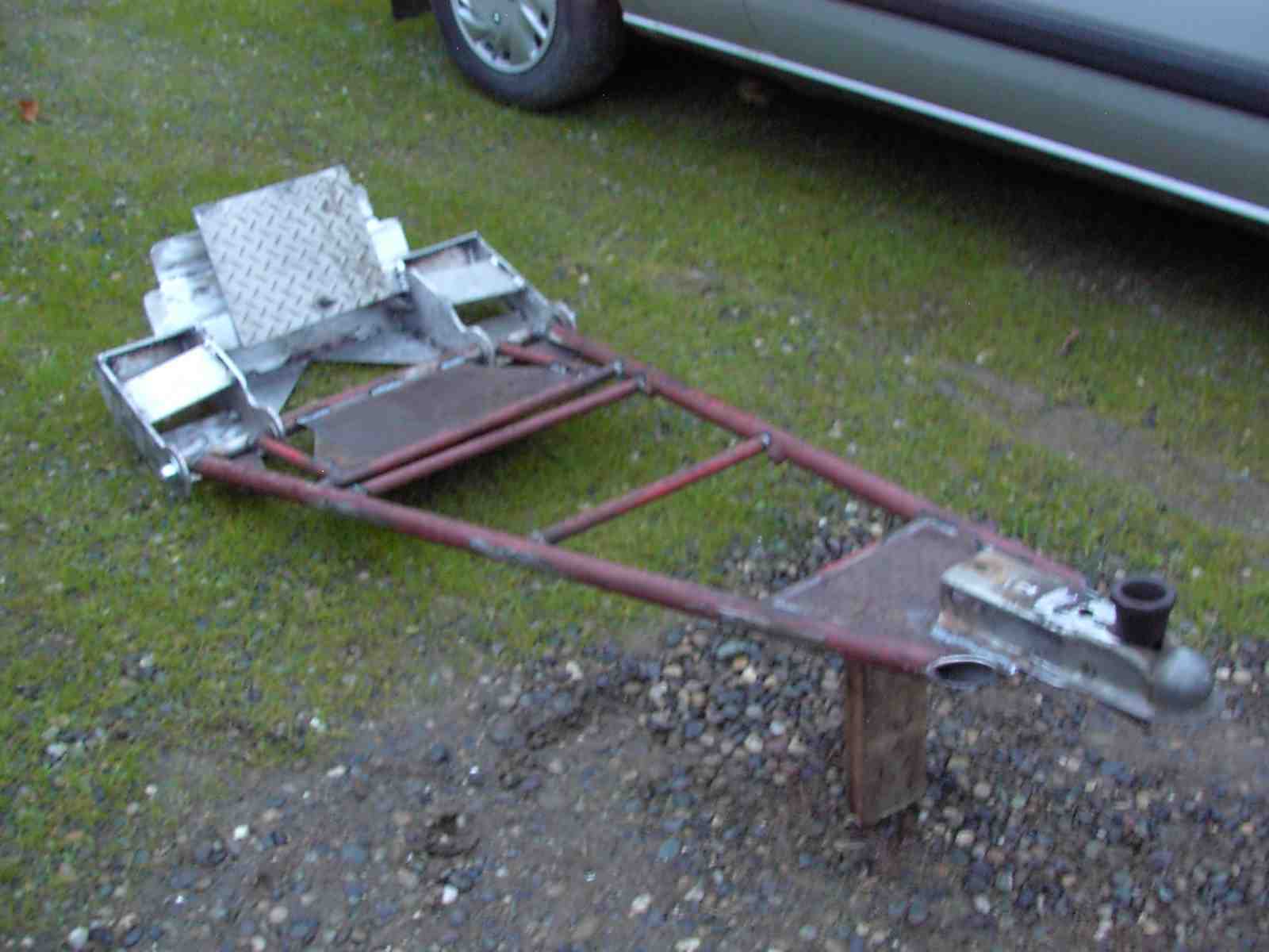

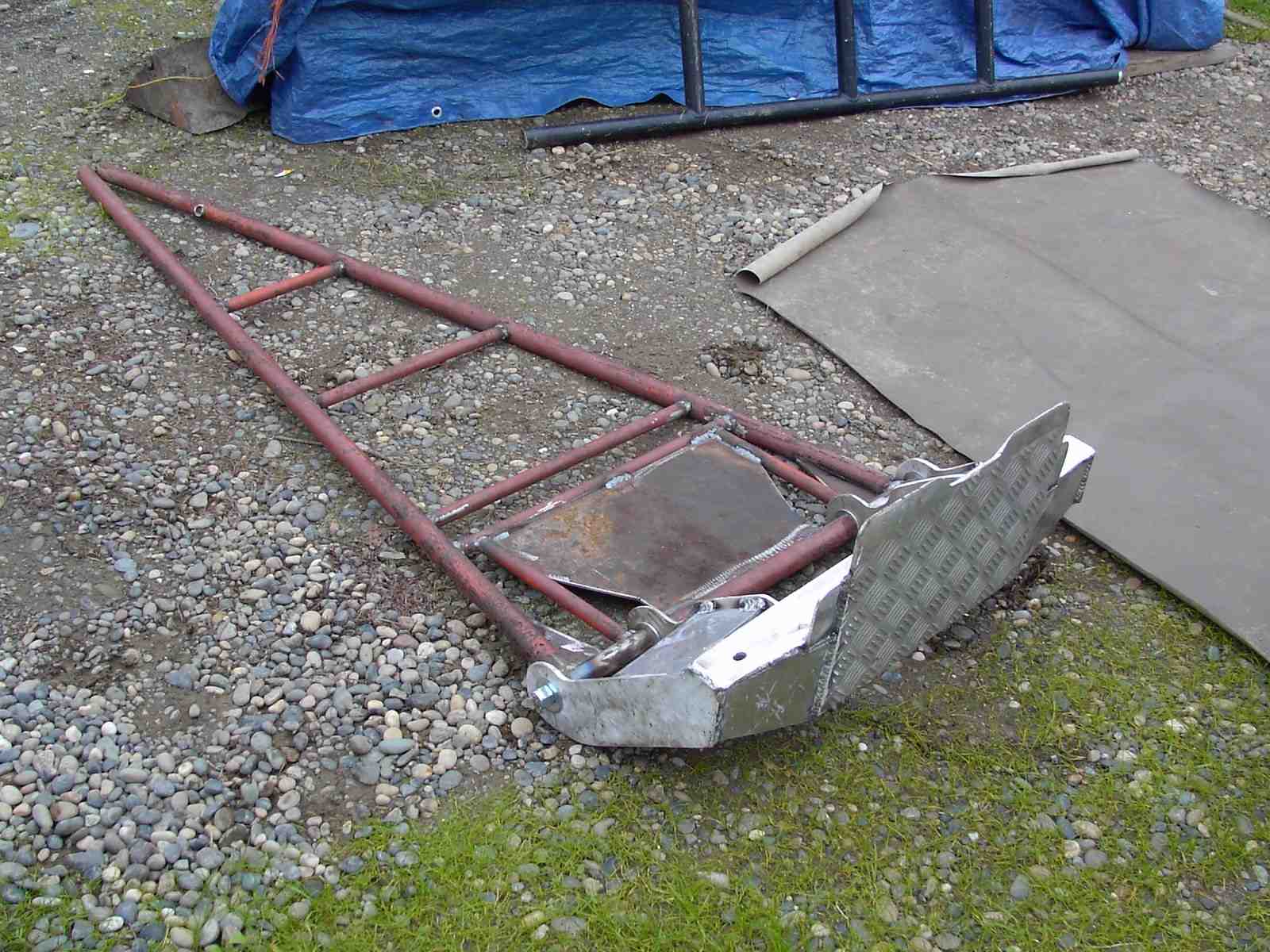

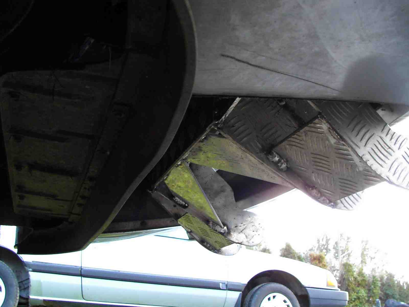

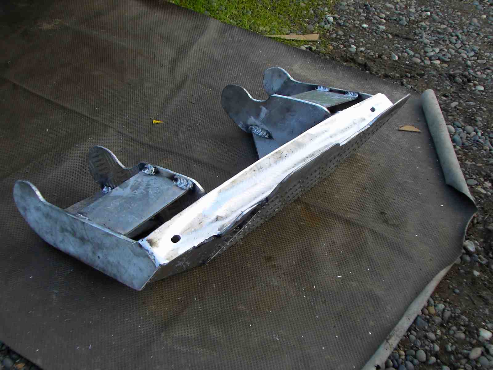

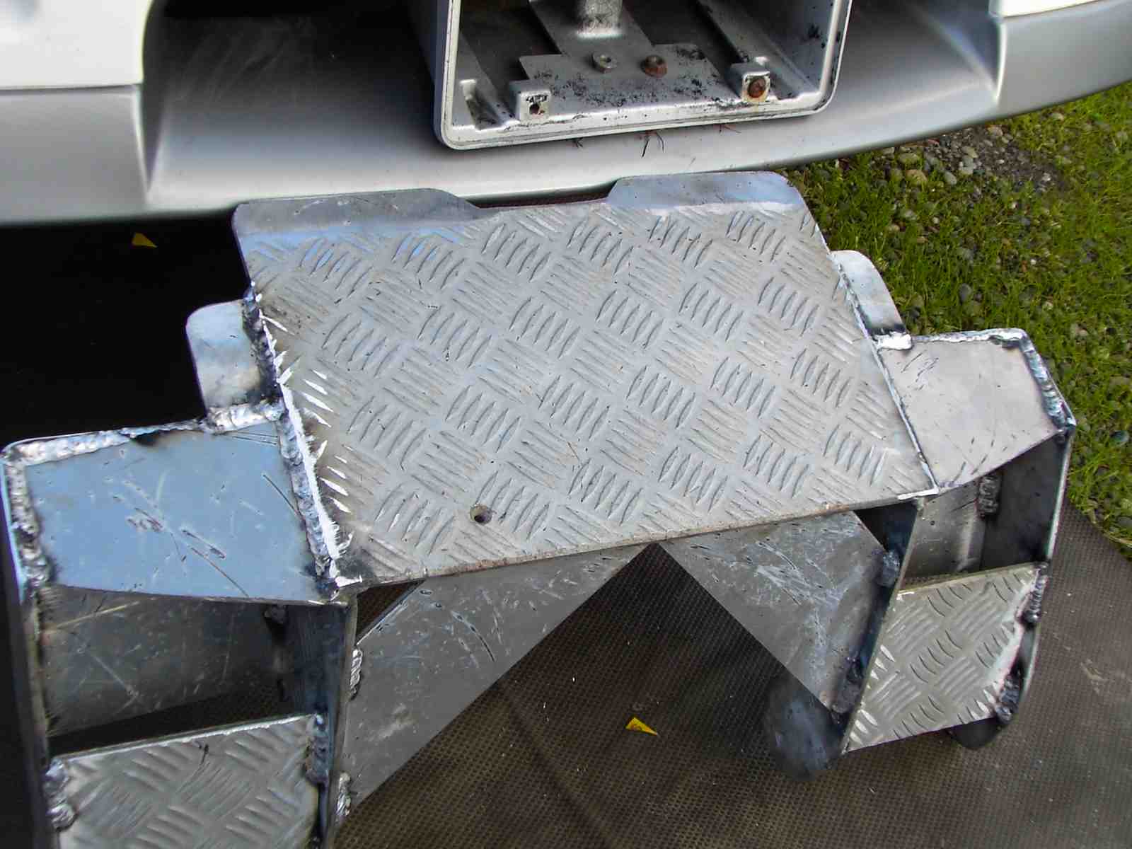

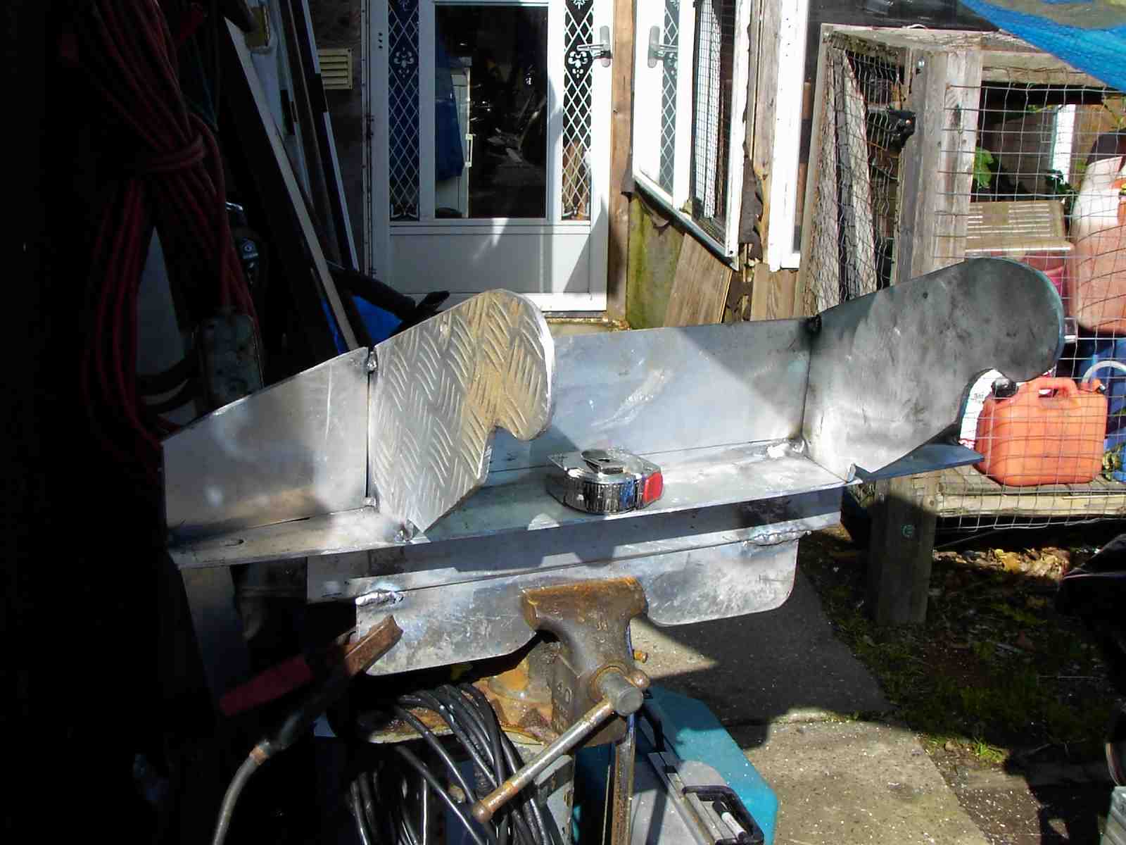

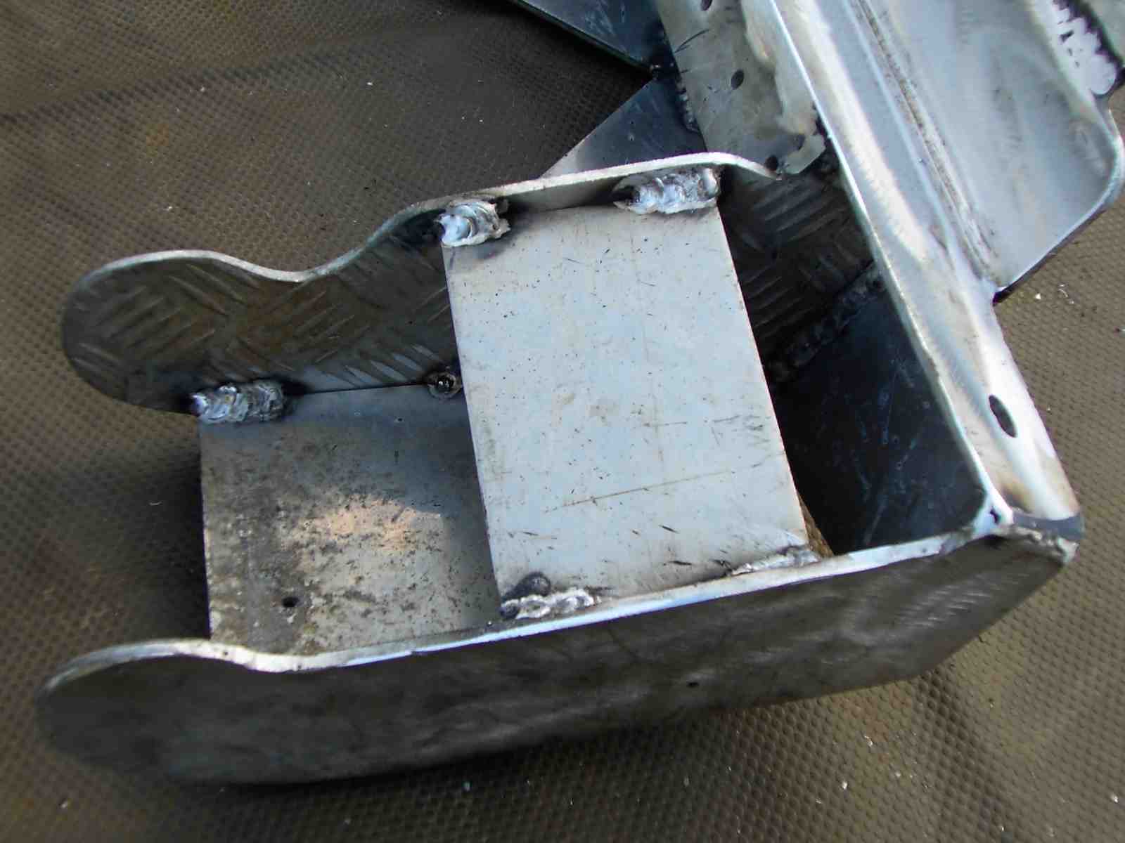

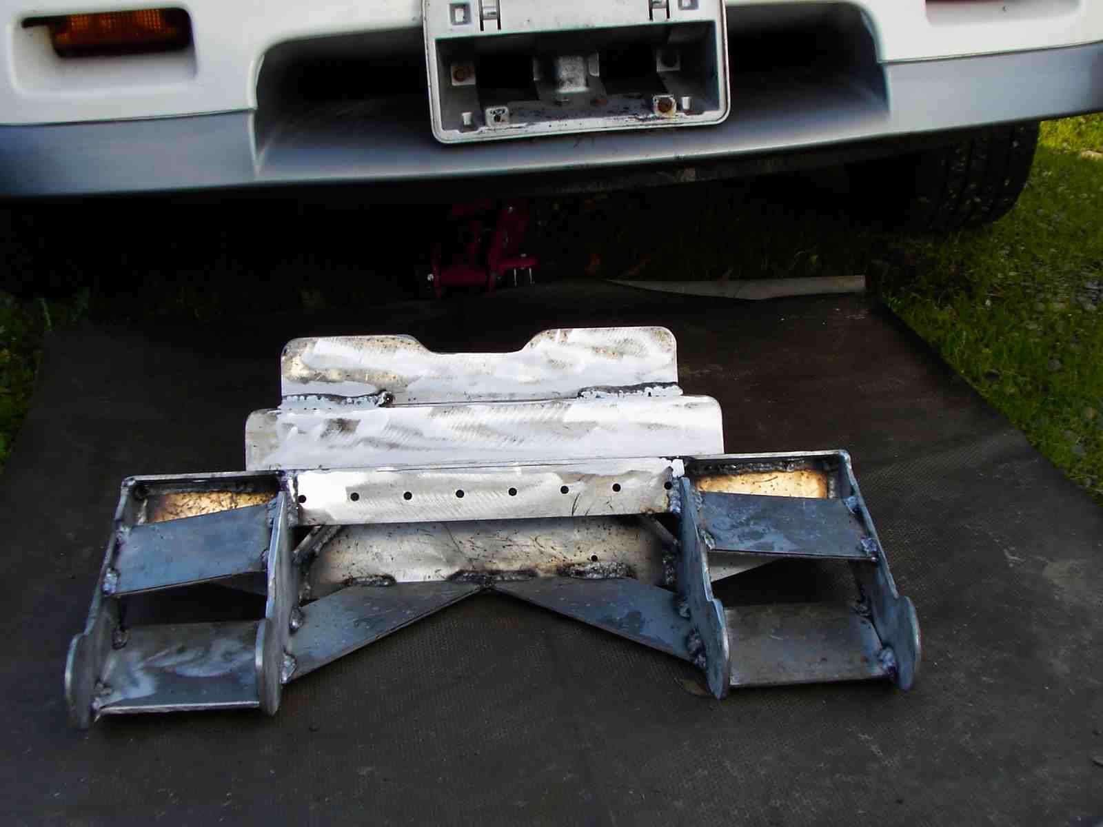

Thanks for the tip Patrick,i fine-lee! got the time to build my #3/point hitch,an first off it was pricey$$$ ALUM #6061 checker 1/4".any how ,iam sure it
will work well,took a bit to make it all work,weld it all up,ect.heres some pics of the whole build up to this point.keep in mind this is the first crack at
this,iam sure theres room for improve-cheers
Post Options Post Options   Quote Dawg Quote  Post ReplyReply Direct Link To This Post Posted: 10 October 2010 at 8:43pm
Wow....that's an awfully long way to your anchor point.  Because you're so much lower than this point there will be a lot of bending force.  I would add more bolts to the upper mounting if it was me.
Other than that, looks good.  The aluminum will be light.
Post Options Post Options   Quote ARTIC-1 Quote  Post ReplyReply Direct Link To This Post Posted: 10 October 2010 at 9:28pm

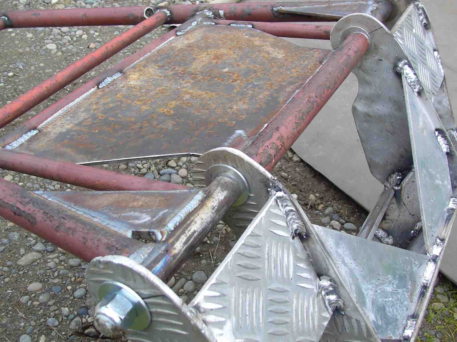

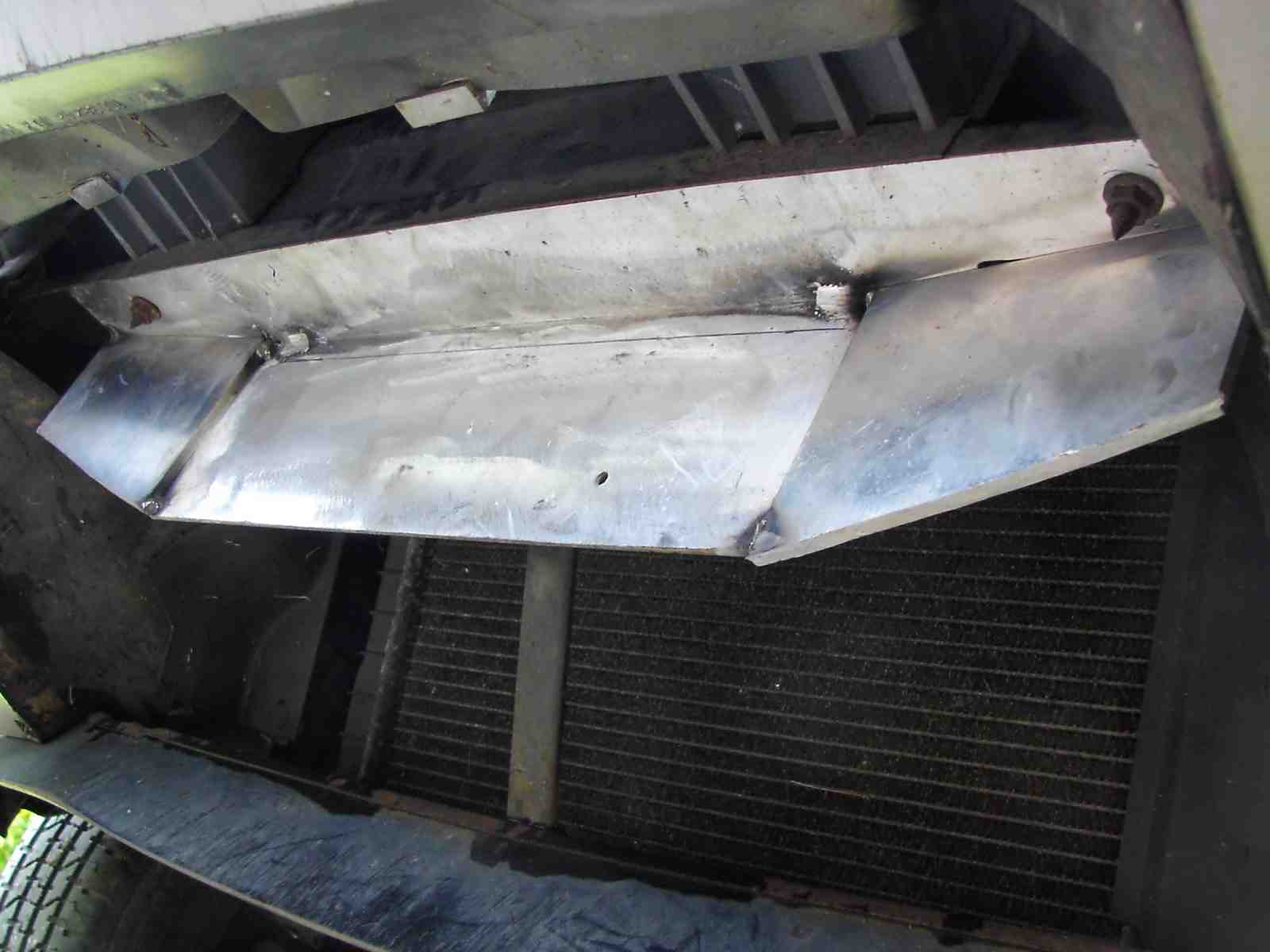

THANKS,it wasn't easy,how it works is,the big plate on the back with the
notch in the top, it fits up in to the frame on the back side in these two
slots,then on the bottom you see the two small bolts that just hold the
frame in place basiclly ,not the main fasting point,it is part of it.then theres
a one more 10'x12x1/4 plate thats bolts to the frame on the front side of
the Fiero,iam not finnish it yet,but will up date soon.have to move my
outher car this week.
Post Options Post Options   Quote Capt Fiero Quote  Post ReplyReply Direct Link To This Post Posted: 10 October 2010 at 11:23pm
Wow that looks amazing cool.  Can't wait to see how it actully hooks up and how well it tows.
Post Options Post Options   Quote ARTIC-1 Quote  Post ReplyReply Direct Link To This Post Posted: 11 October 2010 at 7:37pm

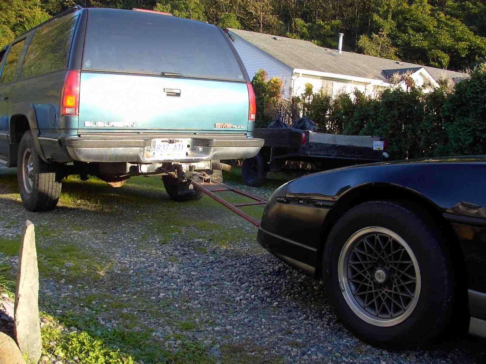

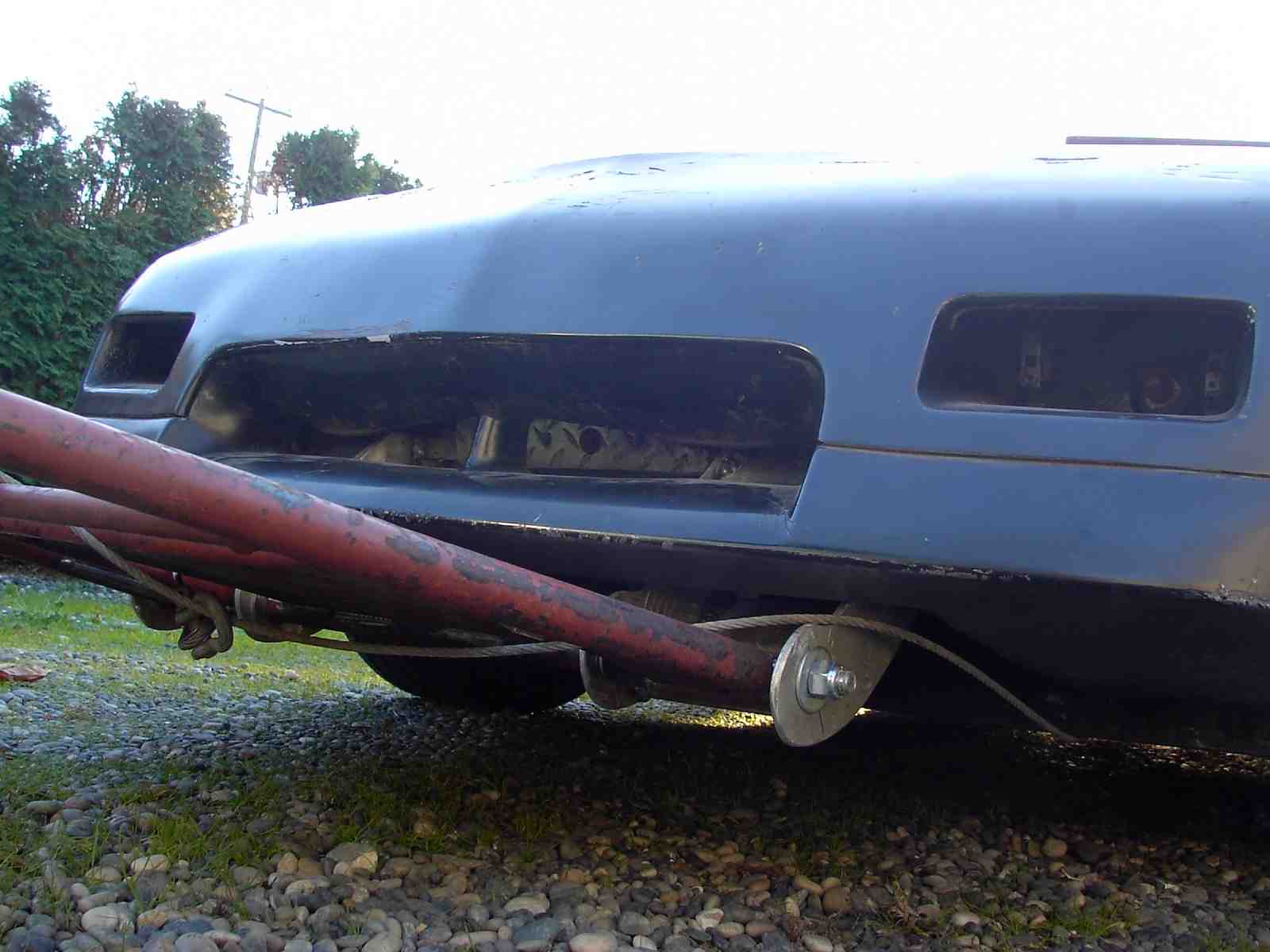

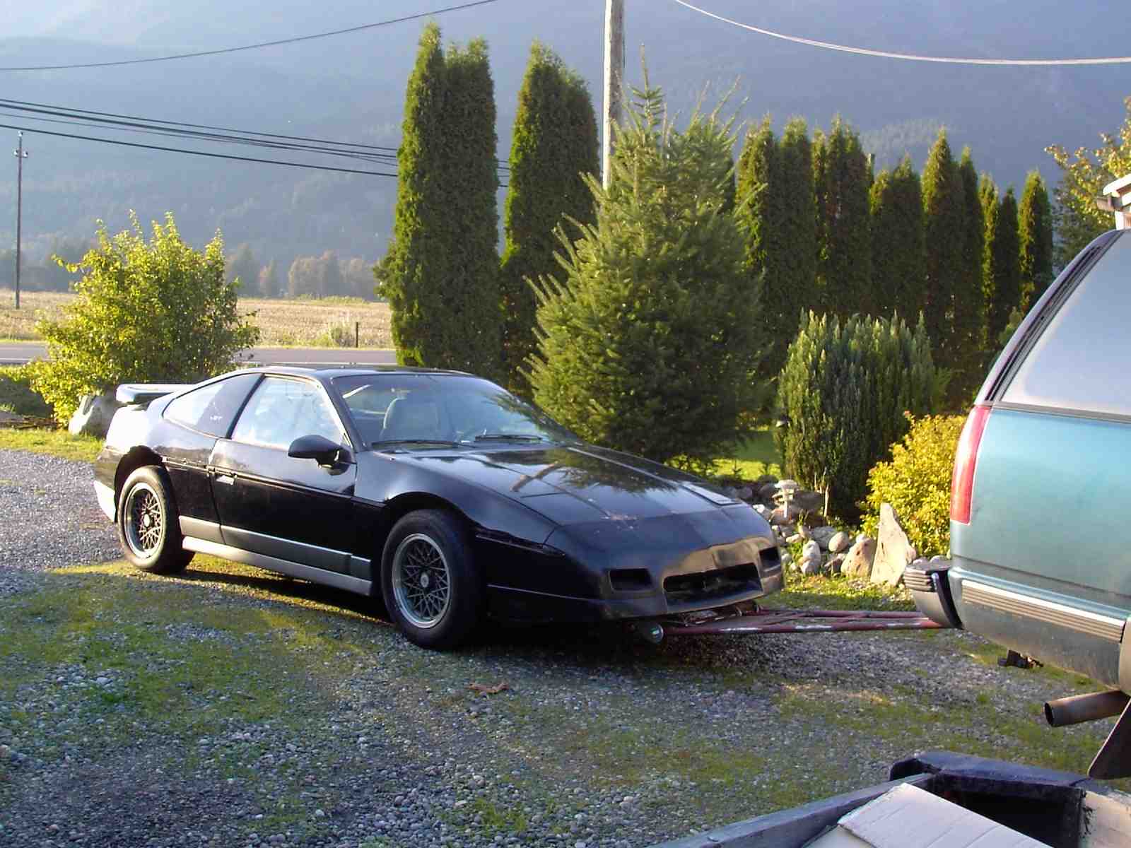

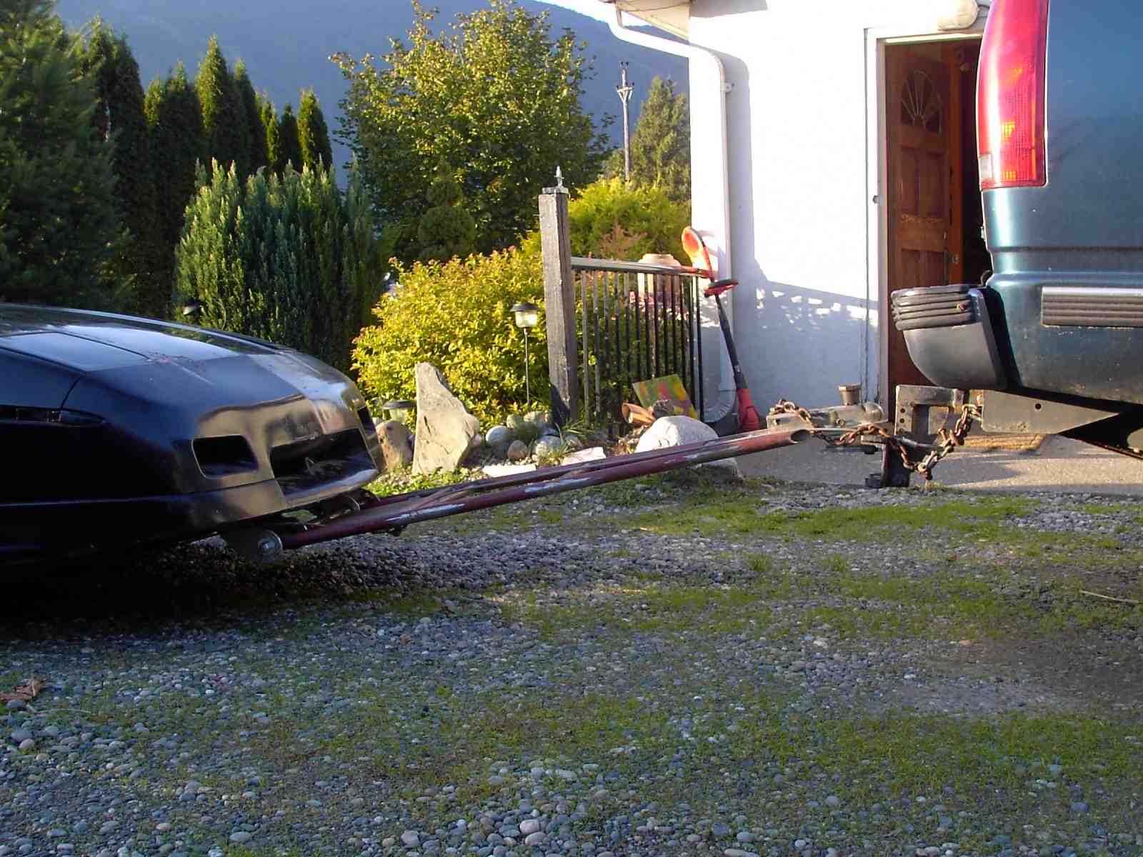

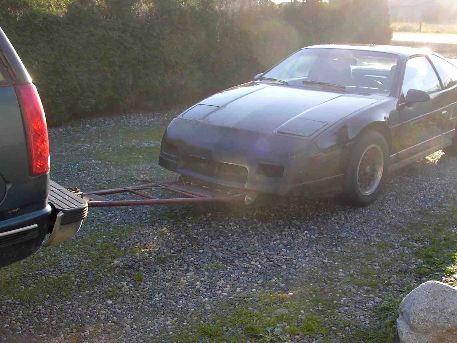

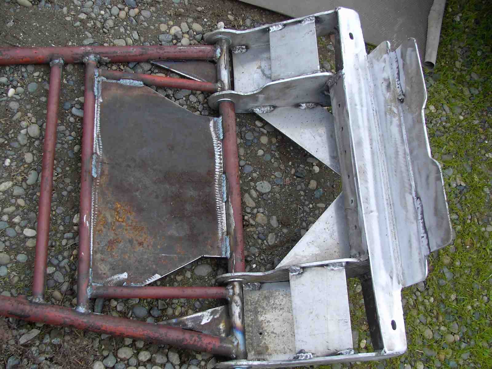

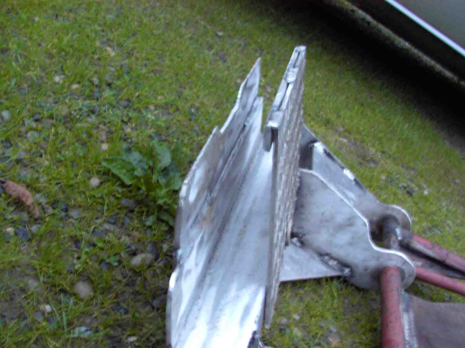

Thanks all,just finnished it tonight! ah,a few more pics---it has about a 5' reach on the toung an will just run a saftey cable to the car from my truck,the
test will be on my parts car thank god! this week an hope all goes well? how it mount to the frame of the Fiero,is with the two large plates that stick up,the
aft one fits up in to two slots way up in the top section of the frame,it inserts in,then you take the two bolts an tighten them up,all they do is hold the frame
in place an give a little extra holding power for everything.then you take the FWD plate an slip it all the way up on the Fwd side,it allmost touches the inside
of the nose,it has a notch in the top of it that fits up on top side of the frame rail,like an upside down J,then insert 2-1/2" bolts horizontally an tighten it all
up,hope it all works?
Post Options Post Options   Quote Dawg Quote  Post ReplyReply Direct Link To This Post Posted: 11 October 2010 at 10:01pm
Hmmmm....somebody knows how to weld....:)
Post Options Post Options   Quote ARTIC-1 Quote  Post ReplyReply Direct Link To This Post Posted: 17 October 2010 at 5:25pm
WORKS so good!!
