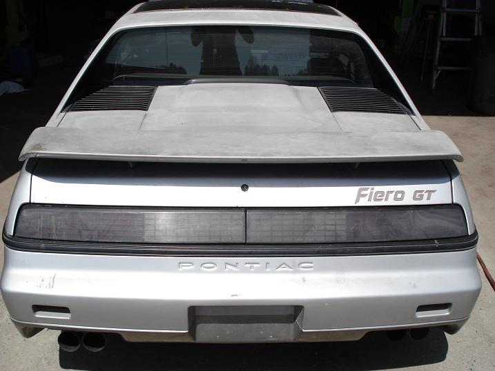

So as the title says, she's an 85 gt automatic.  Got it for $650 because it needs a fair bit of work, but even knowing that, I really think I got a good deal considering that it runs, the tires are in great shape and it had new exhaust put on before it was parked roughly a year ago.  The guy who sold it thought my friend and I were brave or foolish to drive it to delta from maple ridge, he really expected that we were bringing a flatbed.  Made it back with the only problem being that it needed a jump start after we put fuel in it.  Anyway, here's the pics from the first day I got the car.

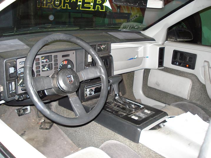

The interior was pretty filthy, pics really don't show how bad it looked or smelled.
Survived the trip with no real issues amazingly
Now I knew it had a lot of problems getting into it, and found more as I started digging into it, but here are some of the problems it had when I bought it:
-no park brake
-no washer tank or pump
-no spare tire
-engine was low on power
-transmission line was leaking

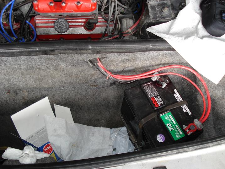

-hole where the battery tray used to be
-left exhaust tip was not installed for some reason when they did the exhaust work, but the seller supplied extra tips with the vehicle (forgot to mention he supplied an extra hood w/scoop, and side scoop panels as well!)
-weak brakes
But the big pain was that every lock had to be changed.  He had no key for the drivers door, pasenger door was punched in, trunk was punched in, and the ignition had either part of a key broken inside, or was just so mangled so much that it worked with nothing in it!  I kept pulling the wire from the coil to the distributor as my only means of theft protection when I parked it.  Seller also had a spare used GM ignition lock cylinder, and included it with the car as well.

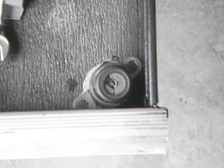

Soon after, I ordered a set of locks, and installed the used ignition lock cylinder.  Those side door locks are a royal pain!  Thankfully I did them last, or I wouldn't have bothered with changing the other locks in the same day.  I took some pics of the trunk lid lock getting changed.  I had to patch up the holes with some epoxy because I had to punch out the old screws since the heads were stripped and badly rusted.

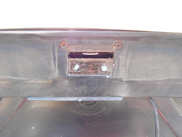

Plate and cylinder were out at this point, just waiting for the epoxy to harden so I could drill new holes.
Here's the old lock
And the finished result, along with the picture of the first time the trunk latch has been closed in who knows how long.

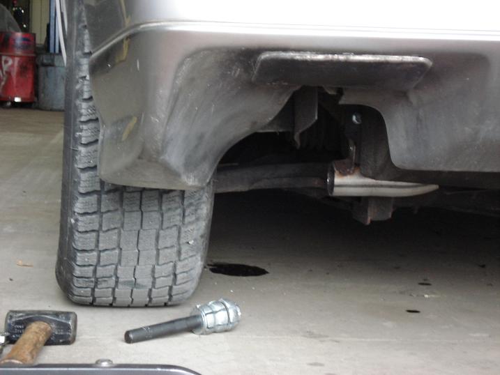

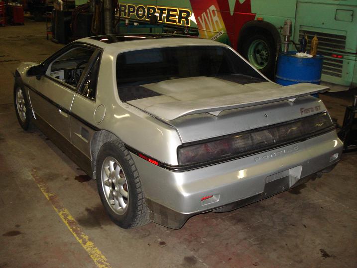

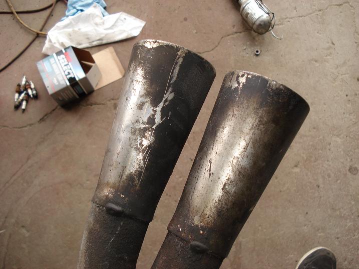

Here's how it looked with the tip out.  You can also see the nice puddle of ATF on the ground from my leaky trans line, that ended up just being a loose clamp, which was a nice break.
I have to mention something funny that I noticed as well.  This very same care was owned by someone else who was/is on these forums.  I was searching through the "old members rides" page and noticed "Vlad's 85 gt" and saw the wheels on his car right away.  They look just like the ones on my car..... appear to be mkIII vw gti rims, so I doubt too many local grey 85 gts would have them.  I looked closer and saw the difference in paint colour from where the bra on the car used to be as well.  The big kicker was the battery though.  On his personal webpage link there's a shot of his rear trunk mounted battery.  Well look at what's under the trunk of mine.....
I just thought that was kind of neat.  Does anyone know if he's still around?

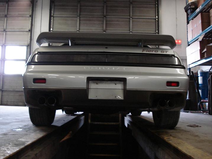

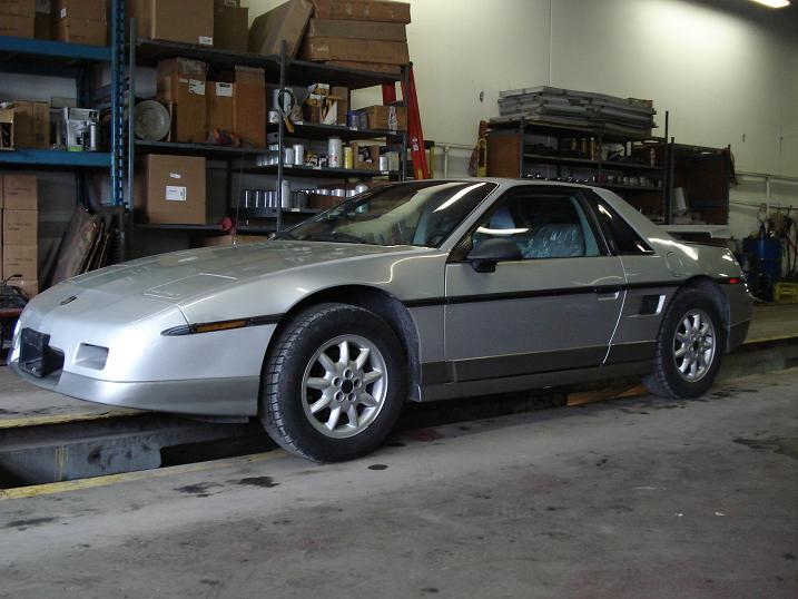

Eventually, I brought it over to our pit (I've been keeping the car at work since all my tools are there and I'm allowed to use the shop on days off as long as I don't get in the way of the mechanics on duty), changed the oil and had a look underneath.
It looks so much better with the tips on both sides!  Underneath looked ok.  Rad support is rotting away, but still holding fine, just needs a patch on the bottom.  Everything else looked decent, it was $650 remember?
