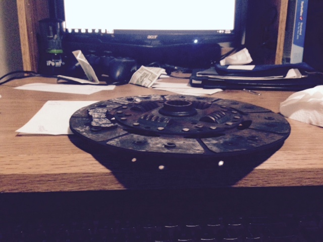

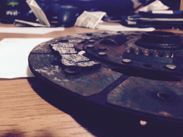

Well ... After getting the hydraulics sorted out I was able to take the car for a spin. I could tell something wasn't right almost instantly. When starting the car would shutter quite a lot. Then, it happened. In 3rd and 4th gear it started to slip.
So long storey short had to remove engine to get the transmission out to get the clutch. Here is what I found.
There seems to be some clutch material missing Smile
I can't believe I was able to drive at all. Anyhow thought I would just share my adventure with you all. I did skip the entire engine remove part but I am sure you have all seen that before. Confused

Post Options Post Options   Quote Fieroman88 Quote  Post ReplyReply Direct Link To This Post Posted: 12 April 2016 at 9:42pm
Wow! Well you're a better man than me as I dread the day I have to do the same. I have pulled one engine and say it's a job. Congratulations to you. 😀
