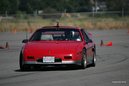

Post Options Post Options   Quote Bassman Quote  Post ReplyReply Direct Link To This Post Posted: 21 July 2010 at 5:28pm
Just in from last weekend...check out the camera location, need to get me a few of these puppies in HD http://www.goprocamera.com/products
