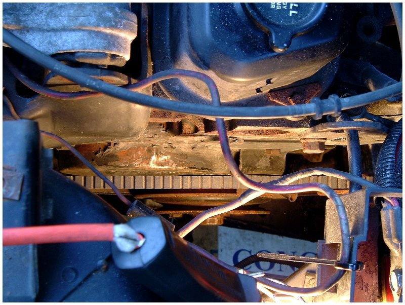

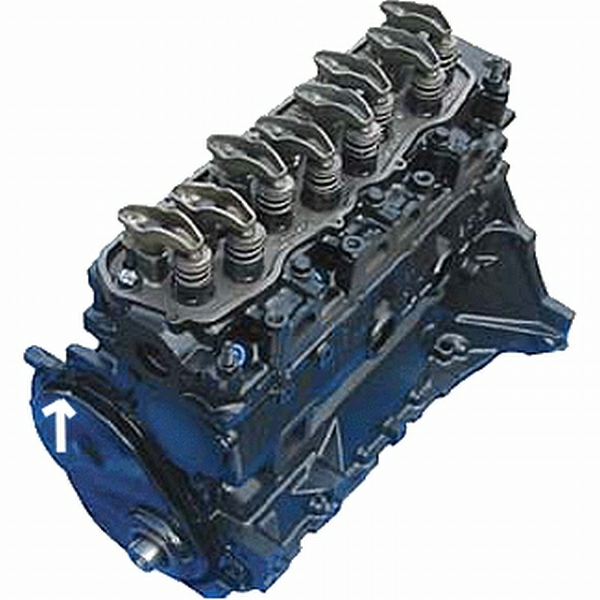

Out of desperation I unwrapped my new mechanic's stethoscope and put it to use. I found the problem, sort of. The noise is coming from something rubbing the inside of the timing cover right at the particular location that the white arrow is pointing to.
So what am I up against here? I don't recall any noise of this sort when I heard the engine running five years ago. Is there something that could've happened while it's been sitting for five years that would result in this "rubbing".
Other than this gol' darn problem, the engine starts right up and runs fine.

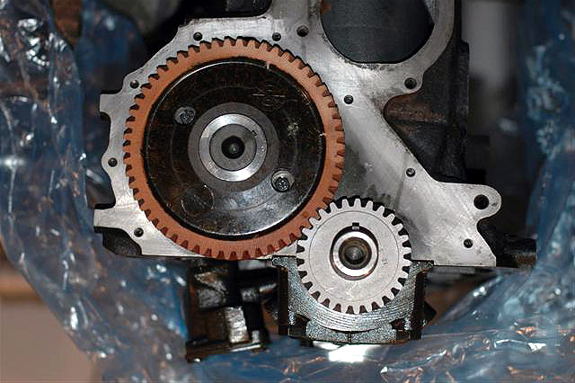

Here's a picture of what's behind the timing cover. (Not my engine, just an image from the 'net.)
So what would cause the camshaft gear to start rubbing the inside of the cover? What's supposed to prevent that from occurring?
Post Options Post Options   Quote Dr.Fiero Quote  Post ReplyReply Direct Link To This Post Posted: 25 September 2009 at 6:44am
Tooth could have broken off and become lodged in a corner.
The nylon gears are prone to breakage.

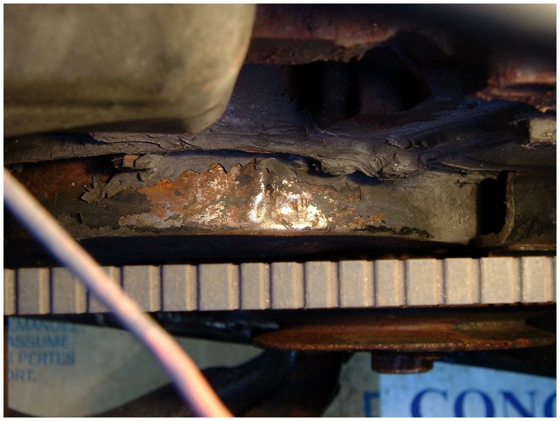

I had another look today, and again used my mechanic's stethoscope. I pinpointed exactly where the rubbing sound was coming from (right at the top of the timing cover) and noticed there was a buildup of silicone there, probably extra that had sort of oozed over from where the gasket is. I peeled it away with my finger. Low and behold, what did I find!
Yep, a dent right at the top center of the timing cover!

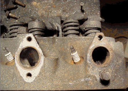

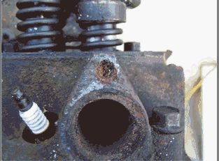

Post Options Post Options   Quote ARTIC-1 Quote  Post ReplyReply Direct Link To This Post Posted: 27 October 2009 at 8:16pm
Did you get your broken bolt on the starter out yet,i had to get x2 out of a
head tonight, they were pretty ugly!!worked out well,all new

couldn't seem to upload multiple pics,this it finnish.
finnish
