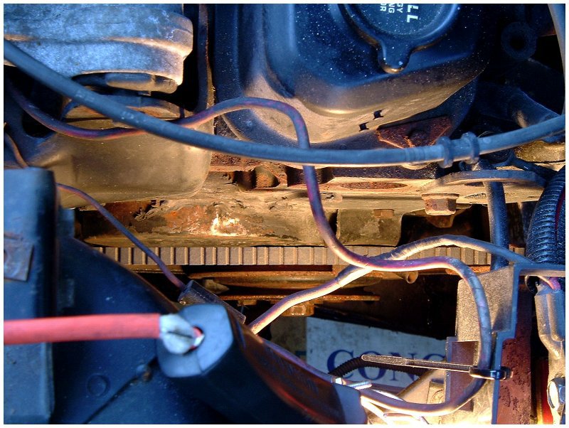

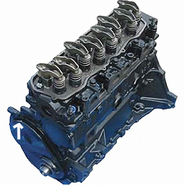

Okay, I made progress, but... It wasn't a vacuum leak. It wasn't the distributor bushings (but I'm still glad I took it off and checked it out as there wasn't any thermal compound between the ignition module and the distributor base). Out of desperation I unwrapped my new mechanic's stethoscope and put it to use. I found the problem, sort of. The noise is coming from something rubbing the inside of the timing cover right at the particular location that the white arrow is pointing to. So what am I up against here? I don't recall any noise of this sort when I heard the engine running five years ago. Is there something that could've happened while it's been sitting for five years that would result in this "rubbing". Other than this gol' darn problem, the engine starts right up and runs fine.

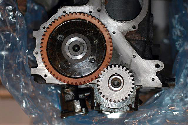

Here's a picture of what's behind the timing cover. (Not my engine, just an image from the 'net.) So what would cause the camshaft gear to start rubbing the inside of the cover? What's supposed to prevent that from occurring?
Tooth could have broken off and become lodged in a corner.
The nylon gears are prone to breakage. |
I guess whatever it is, the timing cover needs to come off.

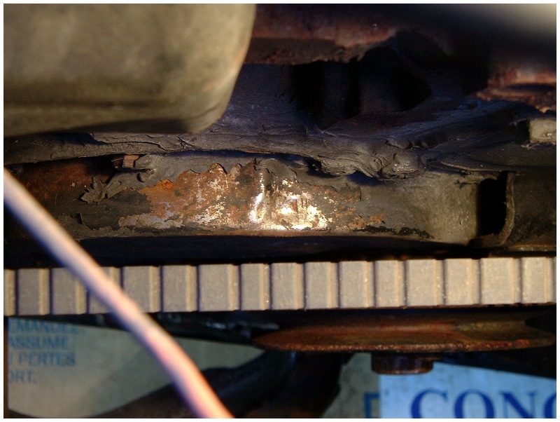

I had another look today, and again used my mechanic's stethoscope. I pinpointed exactly where the rubbing sound was coming from (right at the top of the timing cover) and noticed there was a buildup of silicone there, probably extra that had sort of oozed over from where the gasket is. I peeled it away with my finger. Low and behold, what did I find! Yep, a dent right at the top center of the timing cover! Look's like I've got to drop the cradle anyway to fix the clutch issue. So now I can fix this at the same time, as well as replace the water pump I notice is dripping out of the weep hole. I love these cars.

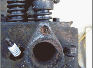

Did you get your broken bolt on the starter out yet,i had to get x2 out of a
head tonight, they were pretty ugly!!worked out well,all new ![]() |
