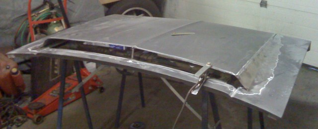

With the weather warming up (yay!!!!) I'm starting to wonder if I'll now run into cooling issues.  Not sure if I can get all the hot air out from under the hood fast enough, so...  it was time to start making the cowl hood I wanted to do anyhow.
Here it is after about 2hrs of cutting up a stock spare one, ungluing the support ribs from it, cutting up some filler panels, and welding them in place.
I've still got to finish the cut edges of course, and then do the filler, smooth it all out and paint it.  So ya know...  another couple hours.  :)
I'll post back when it's done.

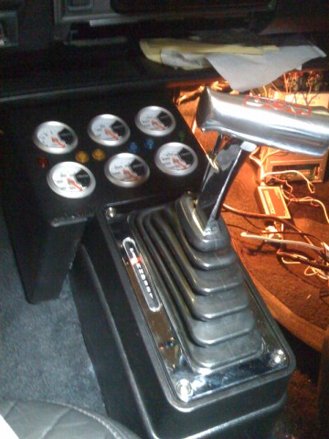

Did a few other things over the last 6 month, but nothing major.  Made up the console gauge panel that a few of you have seen installed
 - but I'm going to pull it out and re-do it since the angle is too steep (near flat!) and I can't see the gauges clearly unless I lean forward and look down on them.
