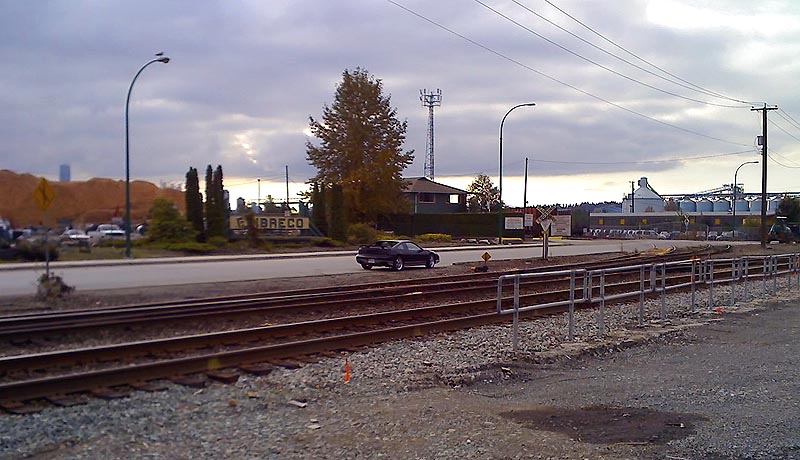

Thought I'd post a cell phone shot of where my GT spent the night. I had just crossed those well used railroad tracks to the left of the shot when the ignition module packed it in for good. |
