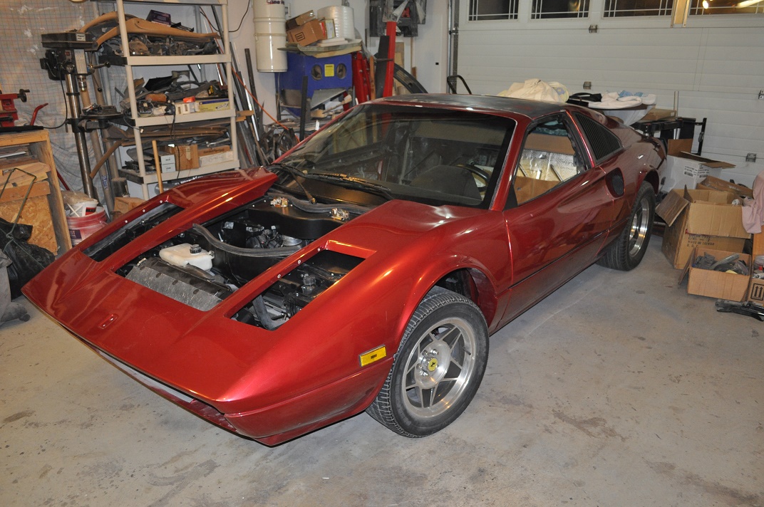

Almost done.
Down to touch ups and cleanups on various parts of the
car.   Hoping to have the first drive by the end of
June....
Don

Well end of June passed and still not on the road.
Other projects and needs taking priority during the
summer. I am cleaning up the front trunk now and hope
to have that wrapped up by the weekend.
Windshield is installed and looks amazing. I just need
to glue in the windshield trim surround as a have a bit
of touch up to do on the driver's a-pillar before
covering up.
Still shooting for a summer drive but I am quickly
running out of time......

Well.  Now into October and still putting, or more honestly, not putting the car back together.  I have the front clip back on and just installing the front trunk today.  For some reason, everything is a little bit off on everything..... Very frustrating when you put so much time into getting everything together and right and then when you paint and go to put it back together, everything is just a bit off.....
Front trunk will be back together today and I hope to get the screen trim in place and then into the interior to finish it all up.  Then I drive it....  I will put some pics up if the image poster is working again.  I see a new forum look at feel.  looks really nice......  Nice, image upload tool works again.  Good job folks.

It has ben so long since I last updated this post and all you on the West Coast.
Car is pretty much done with new 3.4 DOHC engine and fully new driveline and suspension.  I have redone a bunch of my wiring in the interior as I got it wrong so many years ago and just finishing the interior off now.  I have it on the ground and running with a basic tune and will be taking it to the engine guys in Victoria after the holidays and getting a full alignment.  All the final little pieces that take so long to do....
I have been updating Madmechanics.com over the years but the sad part is that the car has been sitting in the garage for a long time with not much progress year over year.  Just been so many other life events going on that pull me away.
I do plan to have the car on the road this spring though and wil decide then whether to sell or keep it while I go after my Countach.
Take care everyone and stay safe in these very intersting times.
Don
