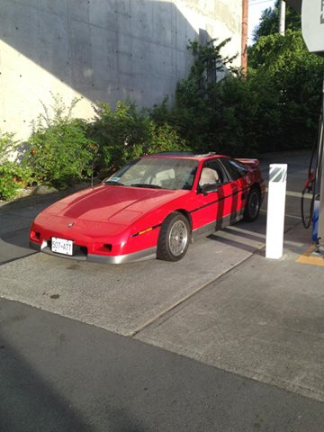

    Posted: 05 June 2013 at 8:37pm
Nice to stretch her legs, not liking some of the sounds but I'll run her for a few days and see how things turn out...forgot how low she is
