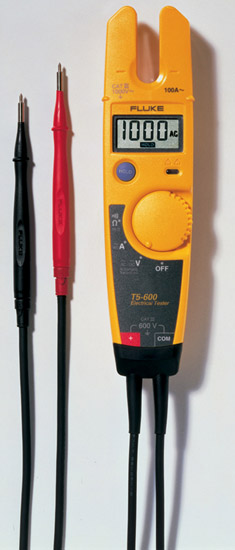

Fluke
This is the Type of Multy meter with a fork at the end Easy to use-to check Load on any wire-AC or DC just stick the wire in between the fork an it tells you the load-10 amps-40A- up to 600 with this meter. an its a regular meter with probes ends. check the two big red 10 gauge wires that are in the Eng/bay when its running doing that surge thing! should take about 5 or 10 min to track down a bad circuit with this typ of meter. |

I have that meter as a backup...it has some limitations. I'm pretty sure it's only an ac ammeter, and the voltage resolution is only units (IE: 10v, 11V, 12V etc). It's meant for a house wireman, but no the best for automotive. Flule does have some good stuff though, I use the 87V, but it's way expensive. A 167 is a pretty good general puropse meter, but doesn't have the current jaw.
DC clip-on current devices usually takes a more expensive measurement device because of the technique required to measure it properly. We use 'add-on' current to voltage converters for this. Chay |
