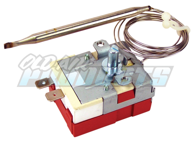

Sound like its that relay thats screwing up.
i changed mine right a way to an adjustable one.works great! Get them at the local auto parts place,you should get rid of that relay. hope this helps. http://www.oldairproducts.com/catalog/accessories/24-0100/sw itch-adjustable-radiator-fantemp-p-2750.html ![]() |
