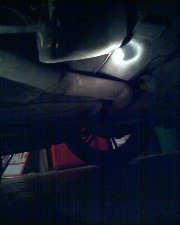

As for the coolant tubes, they are really easy to see under the car without
a jack. They just run along the rocker panels from each wheel. This is a
picture of mine. It is slightly crushed from a lift from before I got my car.
It does still cools fine.

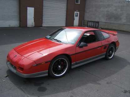

Post Options Post Options   Quote Patrick Quote  Post ReplyReply Direct Link To This Post Posted: 09 November 2008 at 6:41pm
Quite honestly, I think even at $6200 you're offering way too much. You haven't supplied many other details, but unless the current owner has put a ton of expensive new stuff into this Fiero, you'd be paying way too much.
I don't know if you are a member at PFF, but many people down in the States report buying V8 Fieros for a heck of a lot less than six grand. Heck even up here, where prices are generally much higher, there was one advertised locally for $5000 this past spring.
Here's the blurb on it and a picture...
1986 Pontiac Fiero GT Fastback,
4 bolt main 350, 5 speed standard, V8 Archie Adapter kit, MSD billet disibutor, MSD Digital 6 ignition, Heat wrapped headman block hugger headers, Dual 2.5" exhaust, magna flow mufflers, K&N filter, 750 Edelbrock carb, Edelbrock Torquer 2 intake, Comp Cams roller rockers...etc.
17" wheels, nexen 3000 tires 70%, Full poly suspension Bushing, New calipers/ pads/ Cross drilled rotors.
The car has about 150k, motor has about 20k. I have put over 10,000$$!! in this car, in the last 5 years. It passed provincial inspection last year, everthing works. I need to sell this car NOW ASAP it is priced to sell now!!! 5000obo.

Ok as long as I have the attention of a few senior/admin members here......let me hit you with this....I am driving to CA THIS SATURDAY to buy what I feel is a nice Fiero at a reasonable price.  He worked with me a bit on the price, but he wouldn't go below 6200, and I agreed..  The guy is really cool and has been very forthright with me, and he's given me loads of his time on the phone...
What is your opinion on THIS car for 6200?  Only negative I know of, is that the tranny and the rest of the car that hasn't been modified or rebuilt has close to 80 k miles...  other than that, it seems reasonable to me.. what do you all think?
Thanks a bunch!

id say go for it, looks like a really clean ride. Only negative thing i can see is the automatic tranny.. If its rust free (and CA, id think it would be..), sounds like a fair price for all that work.  Some of those things like the Mr.Mikes seats, and (what looks like) Cliff Pennocks digital instrument cluster, cost like $400+, plus the brake upgrade..
Post Options Post Options   Quote Patrick Quote  Post ReplyReply Direct Link To This Post Posted: 10 November 2008 at 5:41pm
This one is $6200 as well?
I'm sure you'll get some other feedback, but honestly, I think it's pretty difficult for those of us up here in BC to comment knowledgeably on the price of a car down in California. I think comparing prices here verses prices there is an apples and oranges situation.
Someone in your neck of the woods would have a much better idea how the price of this Fiero compares with other similar Fieros available down there.
Having said all that, it's a nice looking car. Personally, I wouldn't spend anywhere near that much on an automatic, and I probably would prefer a newer 86/87/88 fastback GT, although that in itself wouldn't turn me off an otherwise "perfect" Fiero.
Whether this one is "perfect" for you, only YOU can decide. Good luck!
Post Options Post Options   Quote Capt Fiero Quote  Post ReplyReply Direct Link To This Post Posted: 10 November 2008 at 5:47pm
Although its is an exceptional example of an 85GT. I wouldn't pay that much for a fairly stock car. Ya it has big brakes and a 3.4, but with an automatic, you can beat that performance for $800 worth of bolt on parts to a completely stock car.
For 6200 I would look for an 88GT or maybe a car that is not so clean but has a good foundation like already converted to at the least a 4.9 Caddy V8 or a 3.8SC car.
However that is just my opinion. All my cars are more go than show, I'd rather go fast than look good.
