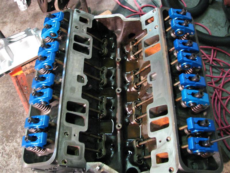

Hey all.
With the intake off I decided to check valve lash.
I got a surprise...
I checked out how to do it in the manual. It recommends swiveling the push rod and tightening until friction is felt then adding .75 turns. this is kinda tough.
I checked pennocks and they recommend going to 0 lash by taking the slop out of the rocker, then go 1.5 turns.
I tried both procedures and for the most part they worked ok. I found the second was the most repeatable and easiest.
The lifters seem to have a sprung center where the pushrod connects. I remember these when I put them in. When I push down on the lifters I can feel them spring back.
Except for two. They seem solid. I guess they are toast?
Anyway, if I follow either procedure the valve starts actuating when I do the .75 or 1.5 turns, which is not right of course. So I left those two looser, so I just got the slop out of the rockers but then didn't add the extra turn and a half.
Has anyone experienced this before??

As far as being in the right spot to adjust them....
I didn't follow the book, but this is what I did:
I rotated the engine clockwise looking at the pulley(passenger) end, and watched as one first valve opened, then the other immediately after it, then adjusted 1/2 turn beyond that.
My way of thinking is that with this sequence, the first valve has to be the exhaust valve opening/closing, then the second the intake opening closing.
Then 1/2 turn beyond and you're definately into the compression/power stroke, both of which are on the base circle of the cam (Non lobe). So I think where the cycle was is fine. I did this for each pair.
How does a guy tell whether they are pumped up or collapsed? They are only 6k old!
The engine has been sitting for 2 months now, so they should be drained one would think?
Chay

Post Options Post Options   Quote CFoss Quote  Post ReplyReply Direct Link To This Post Posted: 05 May 2010 at 6:34pm
Ok, I got the manifold off.
The two which didn't compress are stuck at the top.
I'll try removing them and soaking them and using air to free them up, then reassemble.
Everything looks nice and clean though.
