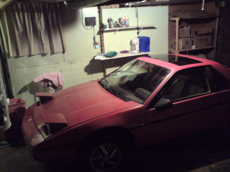

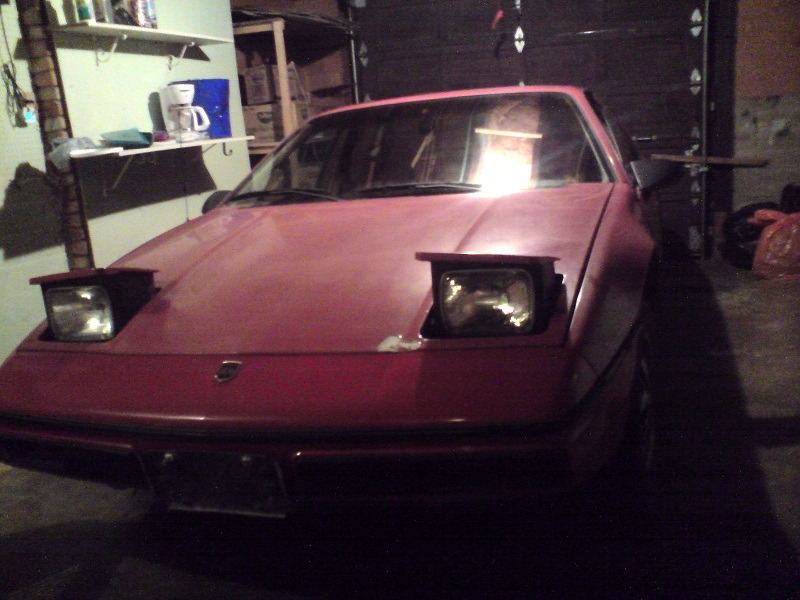

Hey just got this 1984 Fiero SE and found this forum. I wanna basicly learn what i can do with this car. Get some ideas for it.
So here it is.
1984 Pontiac Fiero SE
2.5L 4 cylinder
4 speed standard

  • Join Pennock's or at least visit it (you will do that frequently), since pretty much anything that you will encounter has already been sorted out by other Fiero owners. The search engine is very good. If you don't find what you are looking for in the active forum, go to archives. To find "forum" go down the left column to "fiero search" link. Your apparent headlight problem would be a good place to start. I had a headlight problem and I was able to quickly diagnose and fix the problem thanks to Pennock's.
