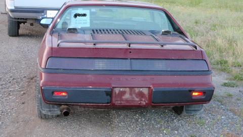

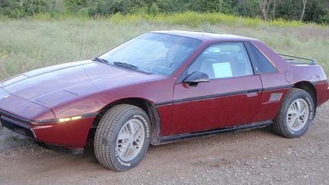

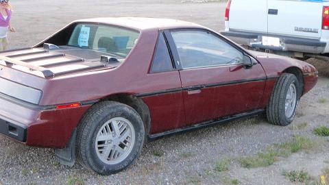

Here's my fiero just bought it over the weekend. 1984 fiero. Gonna fix her up and do some major mods to it.. i'll get some better pictures up tomorrow when I go pick it up and drive it my parents place where I will be doing all the work on it. Hopefully it makes it... engine needs a little tlc... but hey only set me back 600 bucks so can't go wrong with that price. |

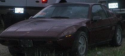

This is the fiero i bought... It didnt make it to my rents place.... the engines basically dead... good thing i don't need it;) pulling engine hopefully this weekend with my dad. any tips?

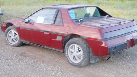

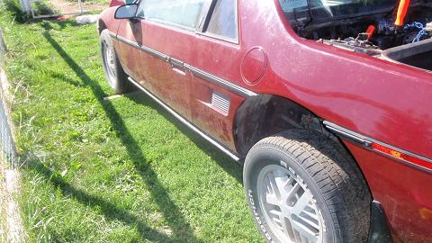

I have no idea did really notice that they werern't on any other till now.... also just noticed that my side bodey panels dont match... one of them has a vent in it... hmmm.... |

Ummm... they're ALL that way. You've got a lot to learn grasshopper.
Driver side (left) just before the rear wheel is for your air intake.

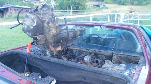

ohhh no sure not:P i got her out the top
skylar ![]() Newbie ![]() ![]() Joined: 23 June 2008 Location: Canada Status: Offline Points: 12 |

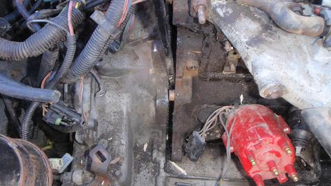

finally got all those hard to get at hiiden bolts off

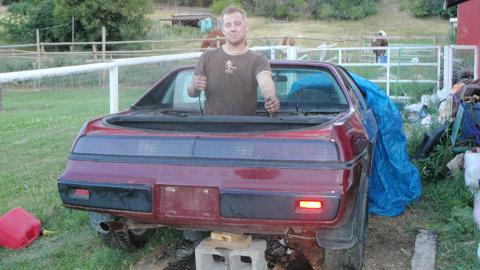

This was very tricky to do but I got her done

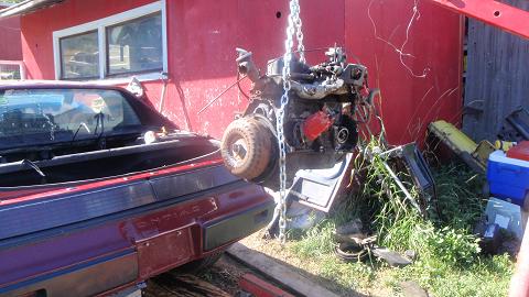

Engines out, time for the tranny... There were lots of those hard to get at bolts.

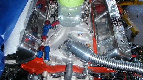

Here's my new engine that I'm putting in.
Just kidding.... Thats for my dad's 67 firebird.

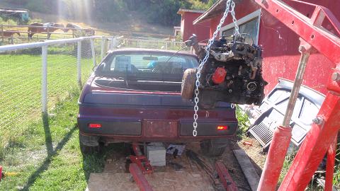

givin the ol thumbs up on my first engine and tranny pull
It looks mean with the rear end lifted... stored in memory bank for later;) |
Do yourself a favour....
Drop the cradle out now. Clean it all up, and the engine bay. Reassemble your new engine, tranny, CV's etc on the cradle, then put it all back in from underneath the way it supposed to be done!! FYI - you wire the whole thing beforehand - then it gets pushed through the firewall, and attaches to the ECM. |
