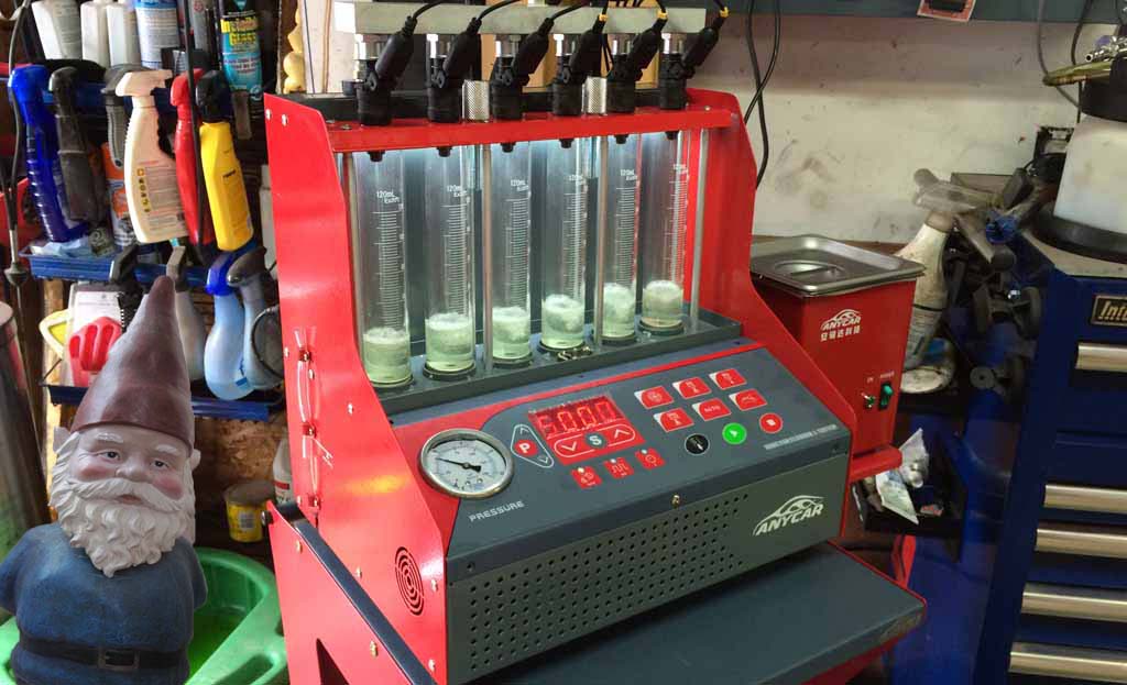

Now I admit, my involvement with services has been pretty skinny
as of late, but.... !! I've got new equipment coming, and will be able to offer (off-car) fuel injector flow testing, and cleaning. NW Fuel injection charges ~$50/injector (which is pretty common pricing). I'm going to offer the first 2 people (or 12 injectors!) for $20 each, then $25 each after that. That's for a pre-flow test, cleaning, then post flow test. If you end up with any that are too high or low to get a reasonable match, it'll just be $20 to do additional ones (that you supply). With most peoples injectors being 25-30 years old, it's probably more than time to do them! Email me - dr.fiero@gmail.com for best results! Edited by Dr.Fiero |

All the new equipment is here.
Did a test run on a REALLY old set I had laying around, and even they showed a huge improvement. About the only ones I can't do right now (until I get the fixture for them) is the TBI injectors found on the dukes (and TBI 350/454's). |

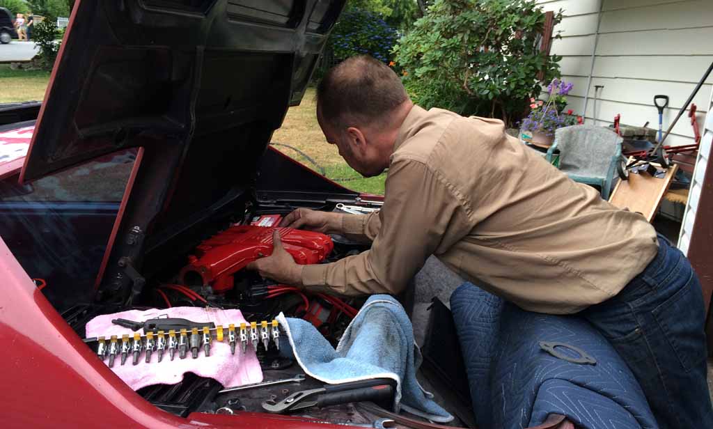

Hi John, picked up Dave's Mom's old car injectors from
Chilliwack Pick A Part and now have enough to clean and have some spares for anyone who ends up with a bad injector. Hope to have them over to you about 1pm on Sunday after work. ![]() |

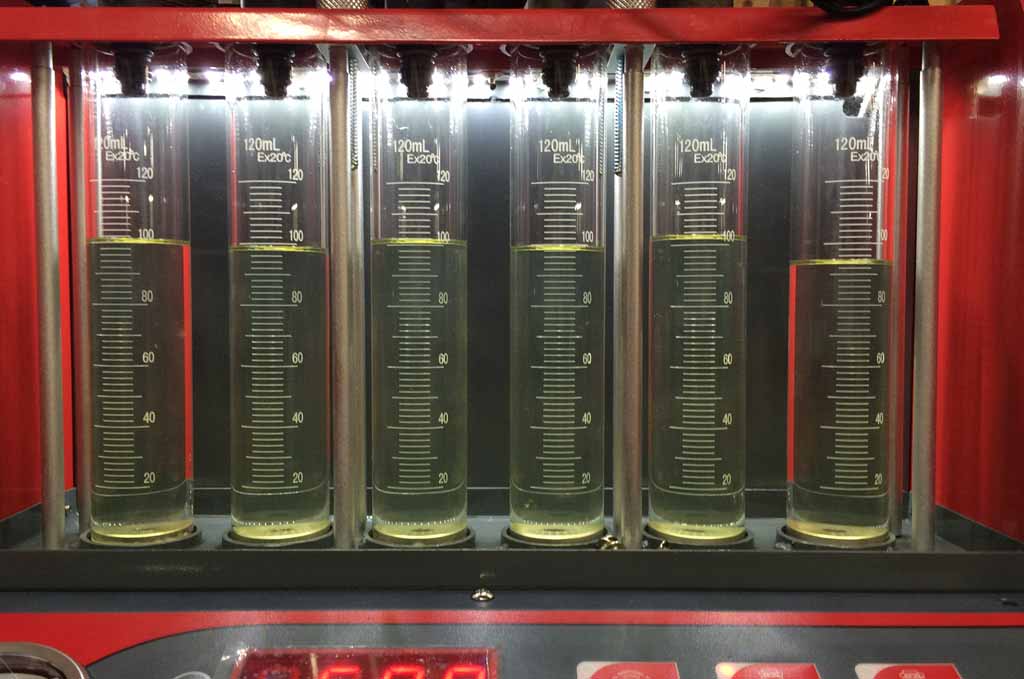

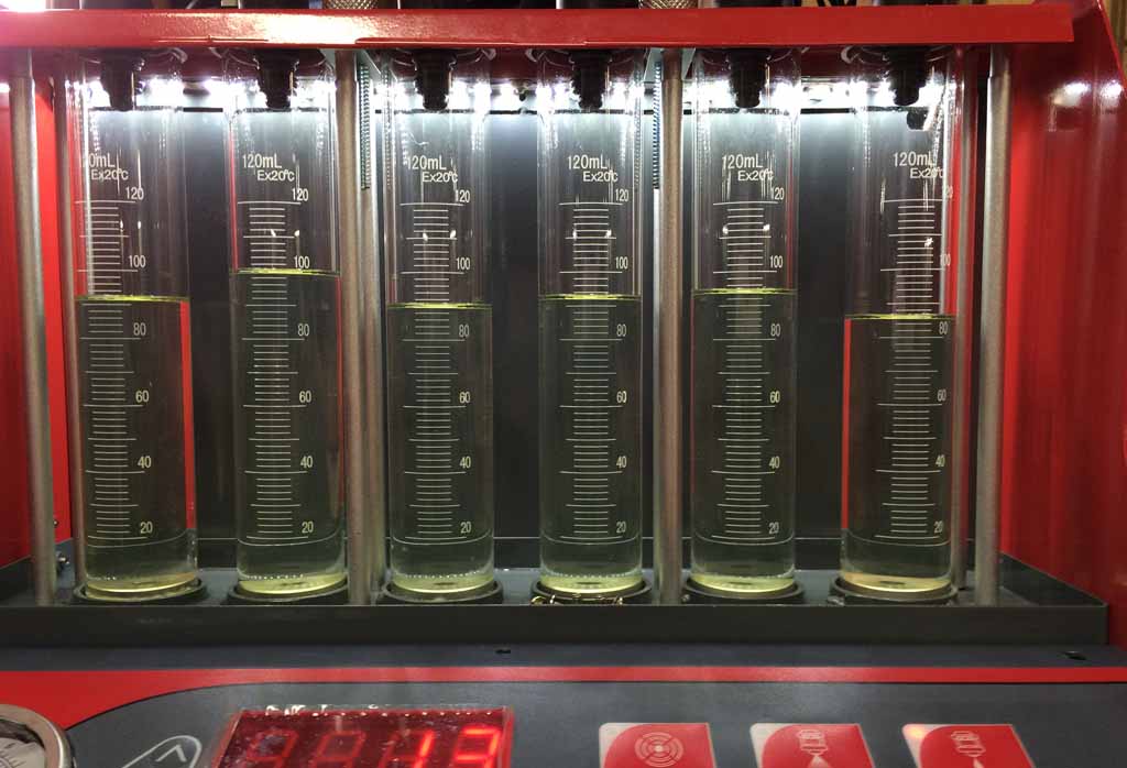

First round of testing/cleaning/matching went well on John Carlos'
car. Went from over 20% variance down to about 5%. Car runs much better now. As for doing Duke/TBI ones - don't think it's going to happen. They want over $200 plus shipping for the fixture. Screw that!! Maybe I'll make one some day. :) |
Dr. Fiero's new toy...
![]() Before... ![]() After... ![]() Dr.Fiero putting everything back together ![]() The Formula runs really different now, just like new ![]() ![]() |
