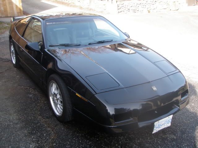

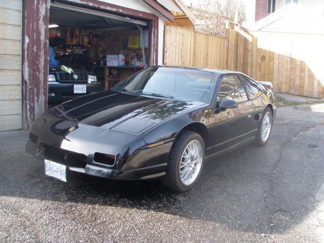

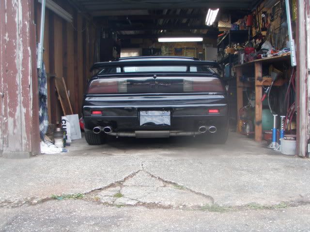

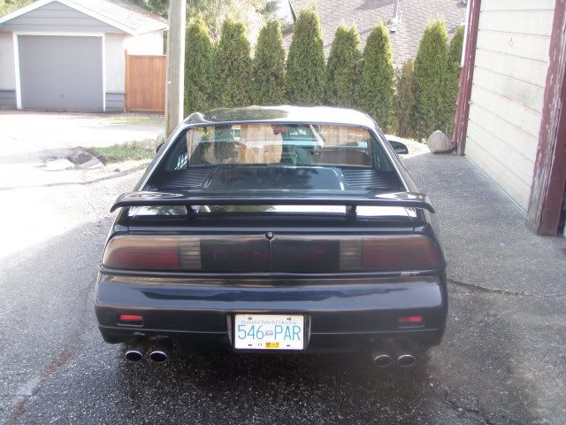

Now that there are some nicer days I figured I would get out and wash and take some new pictures of my fiero.
When I got it:
Exterior

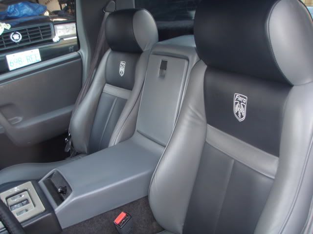

Interior

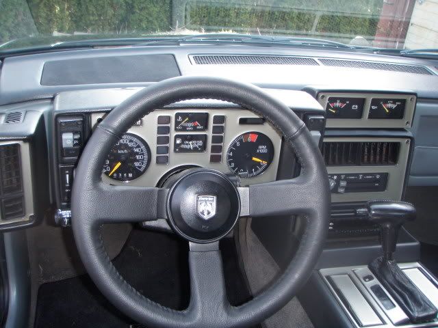

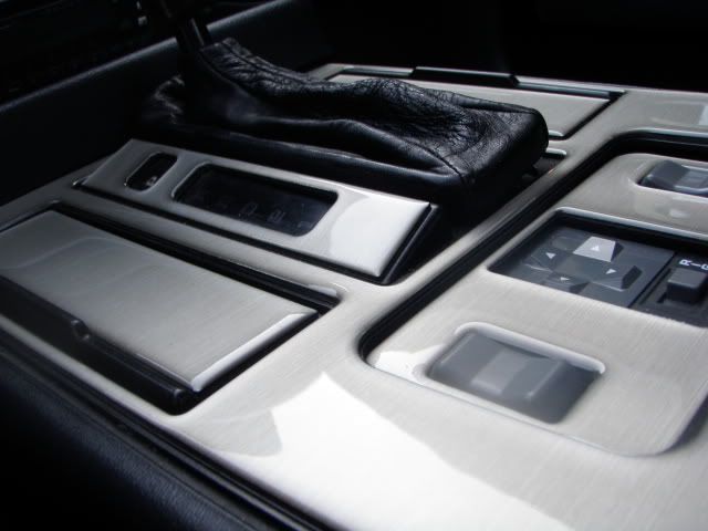

Tried to get a picture to better show the nice trim overlays.

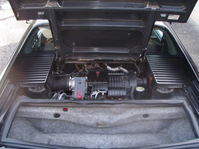

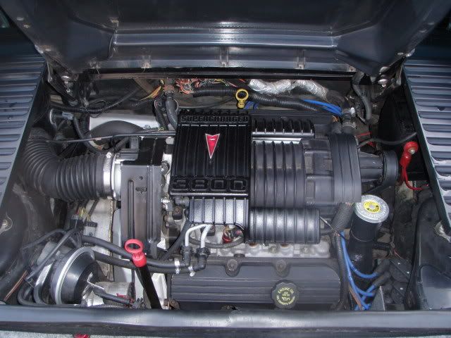

Engine
List of mods to date:
3800 series 1 supercharged V6 from a 1995 oldsmobile
and everything that goes with that- exhaust, intake, ECM reprogram, axles, walbro fuel pump, etc
4T60-e
Reversed the lettering on engine cover and added Pontiac emblem
Trans cooler behind passenger lower quarter panel
Trunk light switch
Aftermarket sound system
JVC head unit, kenwood and sony speakers and tweeters.
Limited Tuning hyper silver rims with nankang NS1 tires
Stock rims have michelin alpins

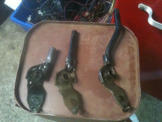

The shifter I got from Dave I decided was a little too short for me, so I made another one.
too short on the left, my new one in the middle, and stock on the right.

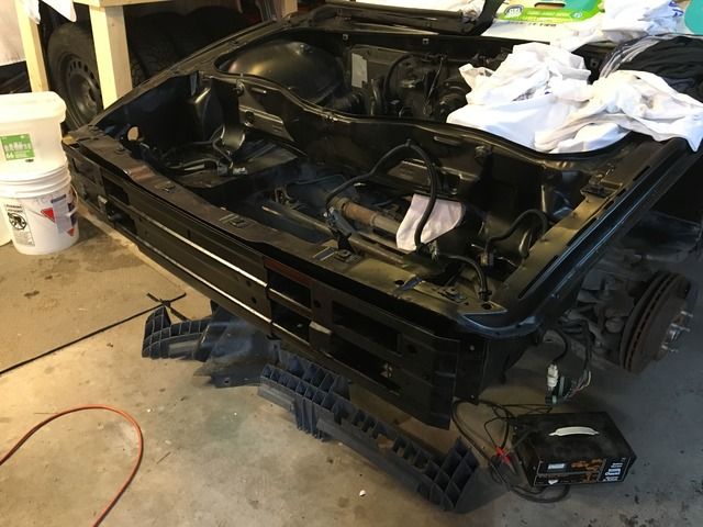

Then no time was wasted before tearing into it. Here is how I left it for the night:
The plan is to basically restore it to its former glory and beyond. Daily driver duty has taken it's toll. The front end is full of rock chips, engine is filthy and the lower half is covered in grime, everything has gotten worn out. But it stil drives great, I've managed to keep the interior in great shape and the 3800/F23 is still awesome.
Even though it won't be on the road much, I intend on doing this work in stages so that I can still take it out for drives and meets and AutoX this summer in between being torn apart.
Right now I've got most of the front end torn apart minus the suspension and will start by cleaning up that area.

Got it just about stripped down as far as I am going at this stage. I'll take out the rad hoses and P/S rocker still and then clean up and reassembly begins.
Couple "before" pics:

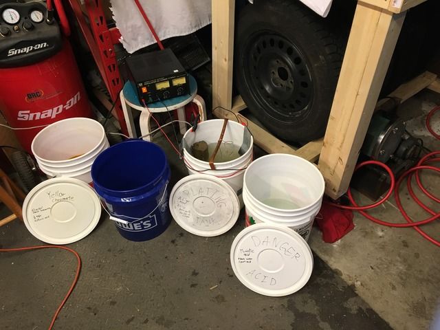

I tried to start some zinc plating yesterday but hit a snag. Power supply was stuck at 45 volts, it's supposed to only be able to go up to 30.
Found the problem I think:
Now to just figure out what that resistor was supposed to be...

I looked up the numbers found on the bottom of the board, and found photos of a power supply with a board with the same numbers! Unfortunately it was not the same board and was no help :(
I tried a few different resistors, 500k and 5k ohm changed nothing. 51 ohm let the smoke out quickly and brightly, so I figure that's close enough to the right value, and my problem lies elsewhere. I will have I keep digging, or buy a new one.

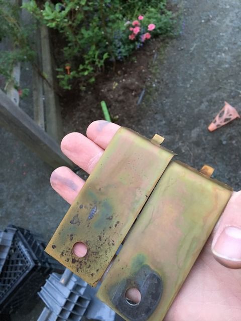

Finally got everything set up for zinc plating, it's putting zinc on things, but not as nicely as I would like, so still need to play with it some more.
Power supply had a dead transistor, so once I figured that out I got t working again.

Still gotta figure out how to make it shinier. And why that one spot didn't get plated and sand blast it better.
Before/after zinc/ after chromate

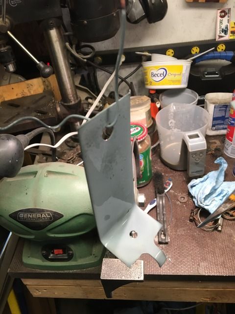

Making a plate to block the silencer ports on my other supercharger.
