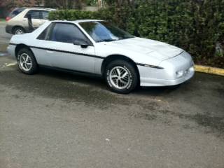

I'm so confused!
I'm looking at 1984 models of Fieros. There are only three models... Coupe,
Sport Coupe and SE.
Which is the one that has the "blunt" nose the SE?, or is that an option?
I'm so confused!

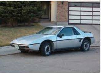

Post Options Post Options   Quote ARTIC-1 Quote  Post ReplyReply Direct Link To This Post Posted: 15 April 2013 at 5:24pm
Its an SE ,,85/86 i think. the blunt nose an the small
long tail lights,no spoiler or real small one.
the lower one is a 2M4 Duke 4 Cyl iam sure

Post Options Post Options   Quote oregonfieroguy Quote  Post ReplyReply Direct Link To This Post Posted: 15 April 2013 at 6:05pm
according to the ad, both pictures were of 84s....
I'm confused.
Were they just wrong? Are are any 84's with this blunt nose? I've seen pics
of other supposed 84s that had that nose...

The only 84 to have the GT nose was the 84 Indy. The Indy was an SE, but not all SE's were Indy's. That nose was then used on the 85GT and later on all the V6 cars in 86 and 87. 88 used that nose on GT's only. Side note you can put that nose onto ANY Fiero. As for the most part all Fiero body panels could be interchanged.
Post Options Post Options   Quote beken Quote  Post ReplyReply Direct Link To This Post Posted: 15 April 2013 at 7:13pm
The only 1984 model of the Fiero with the "Aero Nose" would be the Indy Pace car replica. Otherwise, one could have bolted on one from the 1985 and forward GT.
The 1984 Indy pace car would have a limited edition interior also and is probably worth a bit more than the other 1984 Fieros.   If one had an Indy pacecar replica, he (or she) would not have painted it another colour.   No other 4-cyl Fiero came out of the factory with the Aero nose.
Also, 1984 Fieros were only available in Red, Black or White. Silver was not available.
Given there are no SE or GT markings on the sail panels of the first car, and if the sail panels are the originals that came with the car, then the nose would have been retrofited on and likely the car repainted.
If the first one is, in fact a 1984 car, then there is likely some body work done on it. Check for possible accidents if you are planning on buying it.
