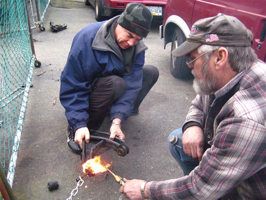

RBS is going to have the suspension tweaked first on a BUDGET

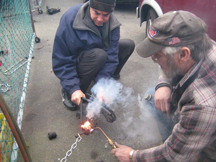

Clynt torching the old rubber bushings until they smoke, burn and slip off with Patrick pulling on chain.
We do it the biker way using a chain

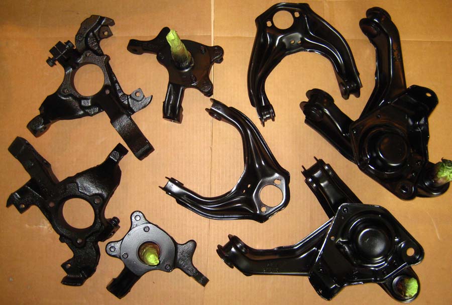

Post Options Post Options   Quote Car-2-Lo Quote  Post ReplyReply Direct Link To This Post Posted: 21 July 2011 at 8:51am

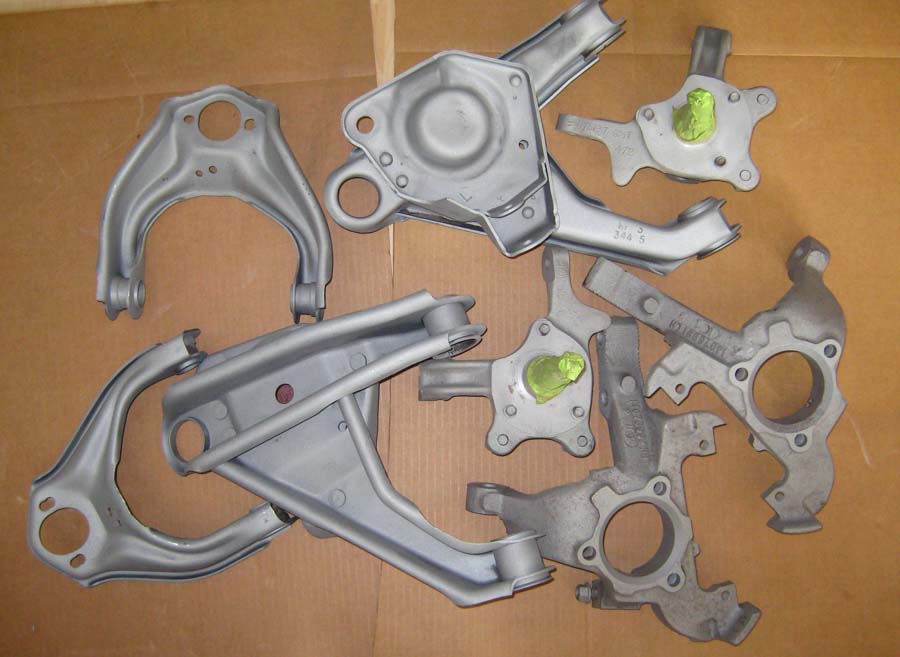

Blair showed me where he takes his parts for sand blasting at U-Blast in LangleyHERE
That feels so good
This is what the parts look like when stripped to bare metal.
Got the rear knuckles from Harrison.

I'm glad Johnny didn't post the picture of me on my ass when the first bushing popped out. I was pulling pretty hard as I didn't realize it would let go completely all of a sudden!
We should probably also mention that those images of Clynt and myself are a few months old. Yes, it's been a cool wet summer, but we're not still dressing quite that warmly this July.

Post Options Post Options   Quote Car-2-Lo Quote  Post ReplyReply Direct Link To This Post Posted: 21 July 2011 at 8:31pm
All parts painted for $18, (no powder coating) remember this is on a BUDGET.

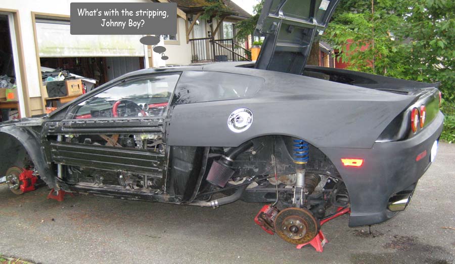

Out with the old
Post Options Post Options   Quote Romeo Quote  Post ReplyReply Direct Link To This Post Posted: 22 July 2011 at 3:09pm
Hey Johnny Boy, what do you intend to do with "the old"?

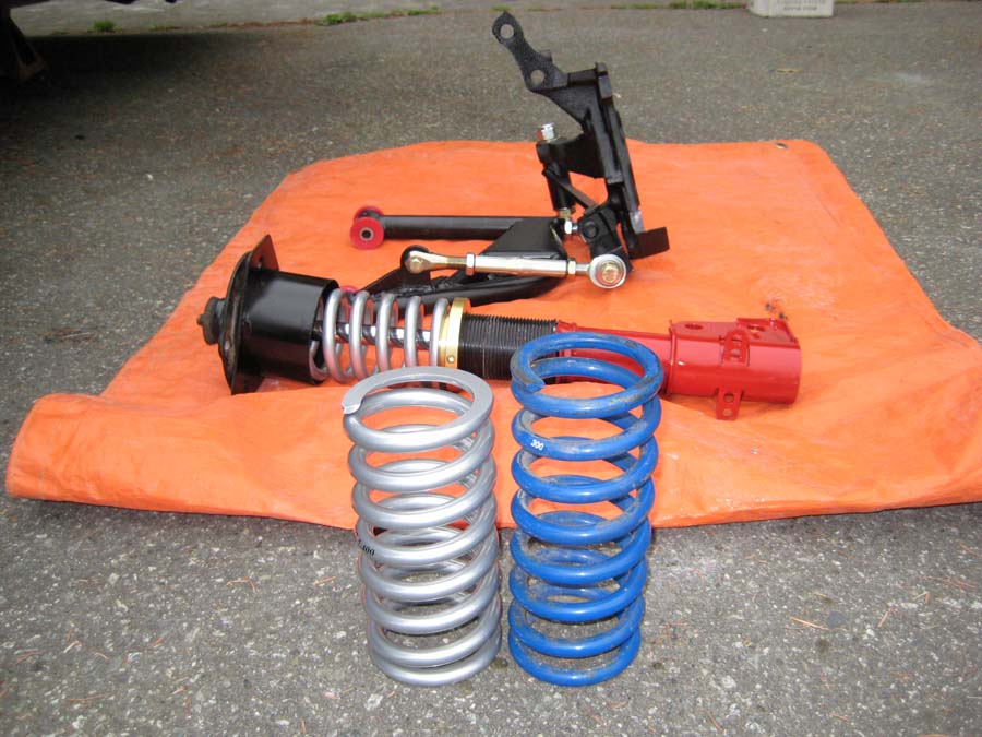

Post Options Post Options   Quote Car-2-Lo Quote  Post ReplyReply Direct Link To This Post Posted: 22 July 2011 at 7:38pm

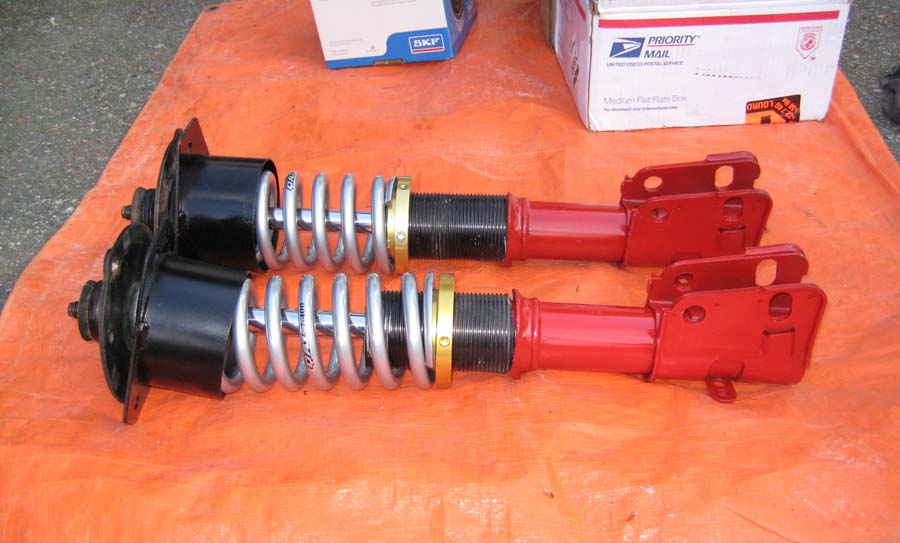

The old coilover kit, changing to 400lb 7" springs, from 300lb 8" springs
Raise rear bump stop by Inverting bump stop plate and painted all parts black with KYBees painted Koni red

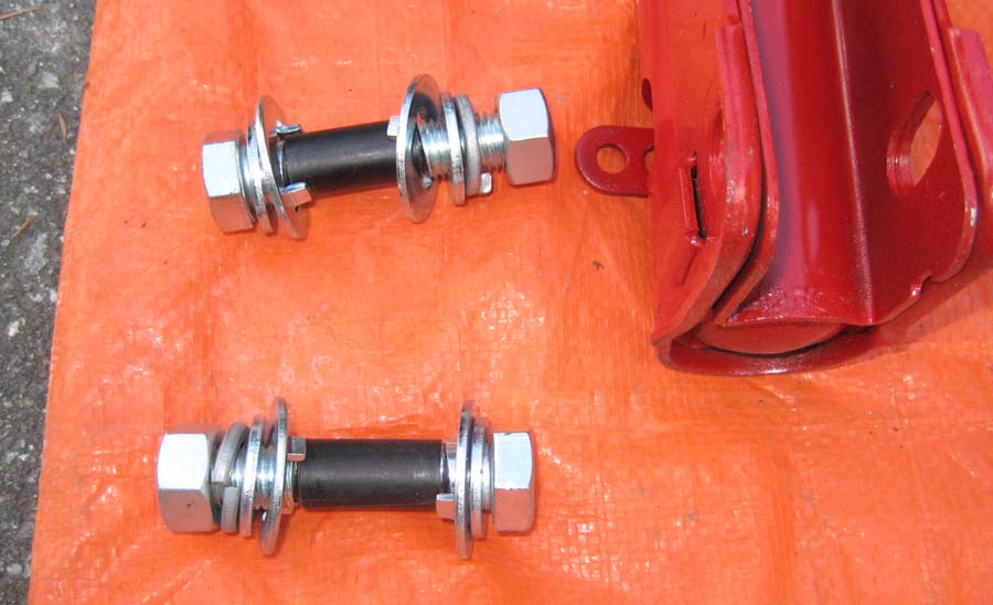

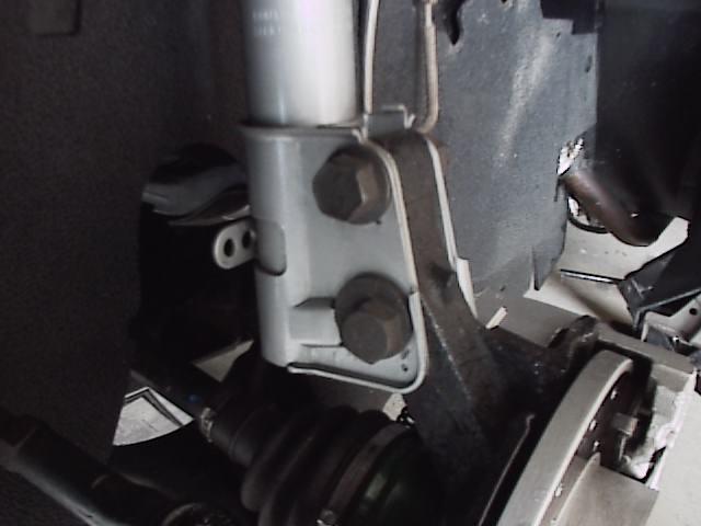

Johnny, when I dropped by yesterday with the ball joint popping tool, you were wondering where the rear camber adjustment bolts went. As this image shows, they go in the bottom hole.
I know your bolts are a bit different (I believe they're the same as what Colby got), but these are what mine look like. Yours have the eccentric on the actual shaft of the bolt, whereas these have an eccentric washer that rides against the protrusions on the strut (as in the picture above).

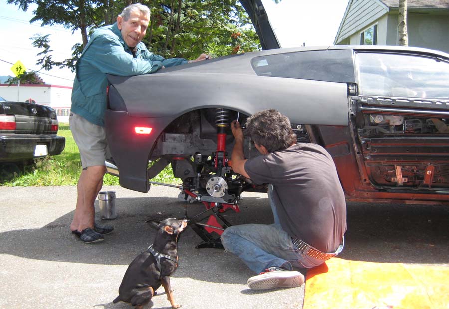

Finally the rear bump-steer suspension is in   http://westshorefabricators.com/Fiero/Fiero-bump-steer.htm

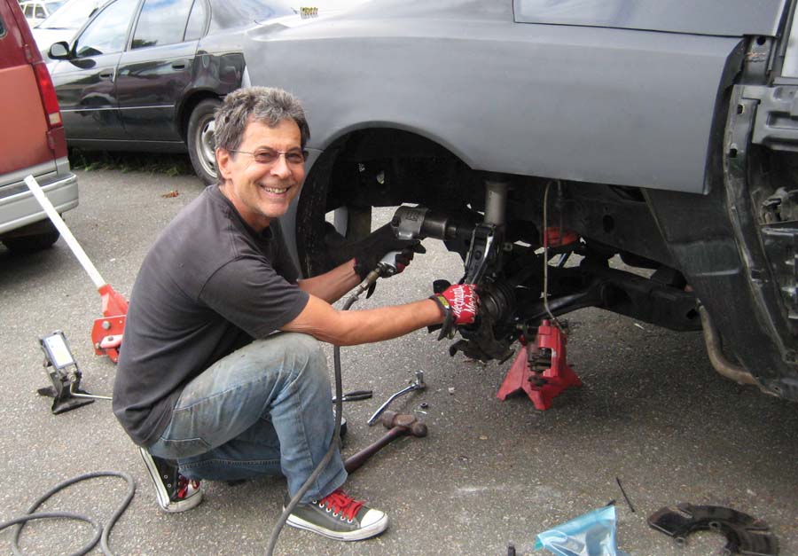

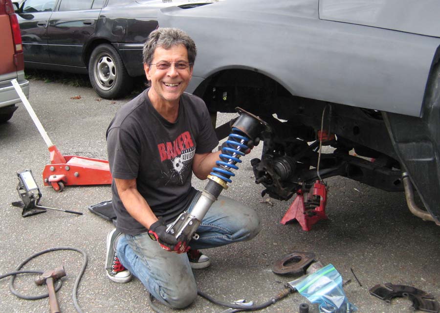

Fred (my brother-in-law at 84) helping me out installing (PAINTED ) Koni red struts.
Just have to slip on brakes next. As you can see in pic I've taken off all wheel well liners and later will be cutting wheel fender about 1"higher.
Dog in pic: I'm baby sitting Clarence ( my daughter's dog ) again
Post Options Post Options   Quote Car-2-Lo Quote  Post ReplyReply Direct Link To This Post Posted: 23 July 2011 at 9:09pm
Patrick, these are the bolts you saw yesterday and I had them about 5 years now, I don't know how they work, maybe the wrong bolts?
So I put on the old ones for now, where can I get those camber bolts you and Colby have ?
