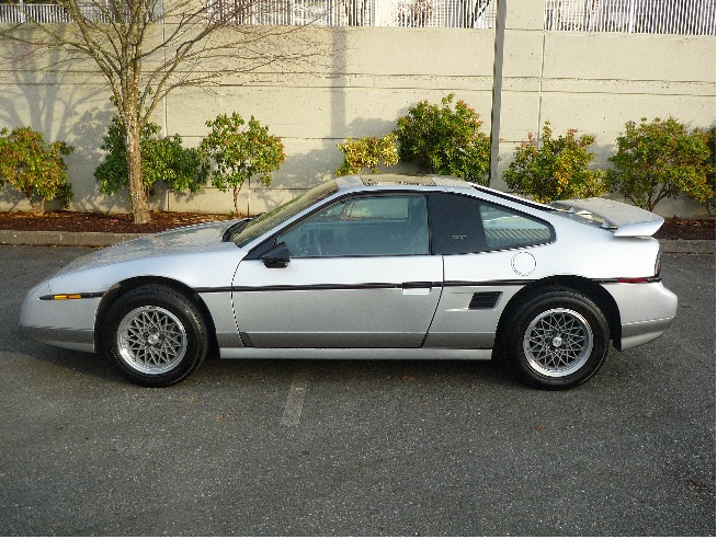

Seems like a long time to warm up i've read it'll idle high for a minute or two and drop to 900rpm suddenly instead of slowly dropping. Maybe a winaldl scan would help instead of me blindly replacing sensors like i read about others doing online. I hear Capt fiero has one, hopefully when i get my collector plates i could come for a tech session and see some nice fiero's. Here's a pic of mine.
