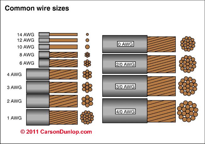

   Gary, I have 0/3 er 3/0 or 3 ought wire that I run for my remote mount battery and I usually use 8g high strand copper wire for power to the amp/amps.  Do you think I'll need to go to 4g high strand copper for this setup.  I know the 8g is enough for  my  current amp, I run the power direct to the battery and ground it to the passenger seat stud.

I'll run 0g for the power and ground as that is what they recommend.  I am running 3/0 (huge freaking welding cable) From the battery at the front all the way to the back of the car, which will give the alternator a bit of a cushion, and this is going into the 4.9 Fiero that has the Caddy Alternator that is IIRC 120amp alternator needed to run all the Caddy electronics. (that obviously the Fiero does not have)  I "might" get a big cap and install it between the amp and the battery, but this system is going being setup for competition class, I just want a bit of extra boom in my Stereo. I am not trying to rattle the mirrors off the car.  I have spent nearly as much on Spark Plugs rotor/cap as I have on this amp/sub combo.  Like I said in an earlier post I can't believe how cheap car audio has gotten.

As far as wire size, bigger is better, and consider a big cap or an ultra cap for filtering. With that much current flowing, make sure the grounds of the head unit, and amp are tied together well to prevent ground rise oscillation from occuring.

     I was out doing Christmas shopping and browsing the electronics section, I came across speaker wire and realized that I didn't have any at home so I better grab some for the install.  Honestly I have no idea what gauge wire to buy.  They had 18g to 12g I went ahead and bought the 12g but not sure if that will be big enough or not.   Anyone have any idea what size speaker wire I should be running?

12 will be fine from sub to amp ...just remember shorter the wire the better :)
