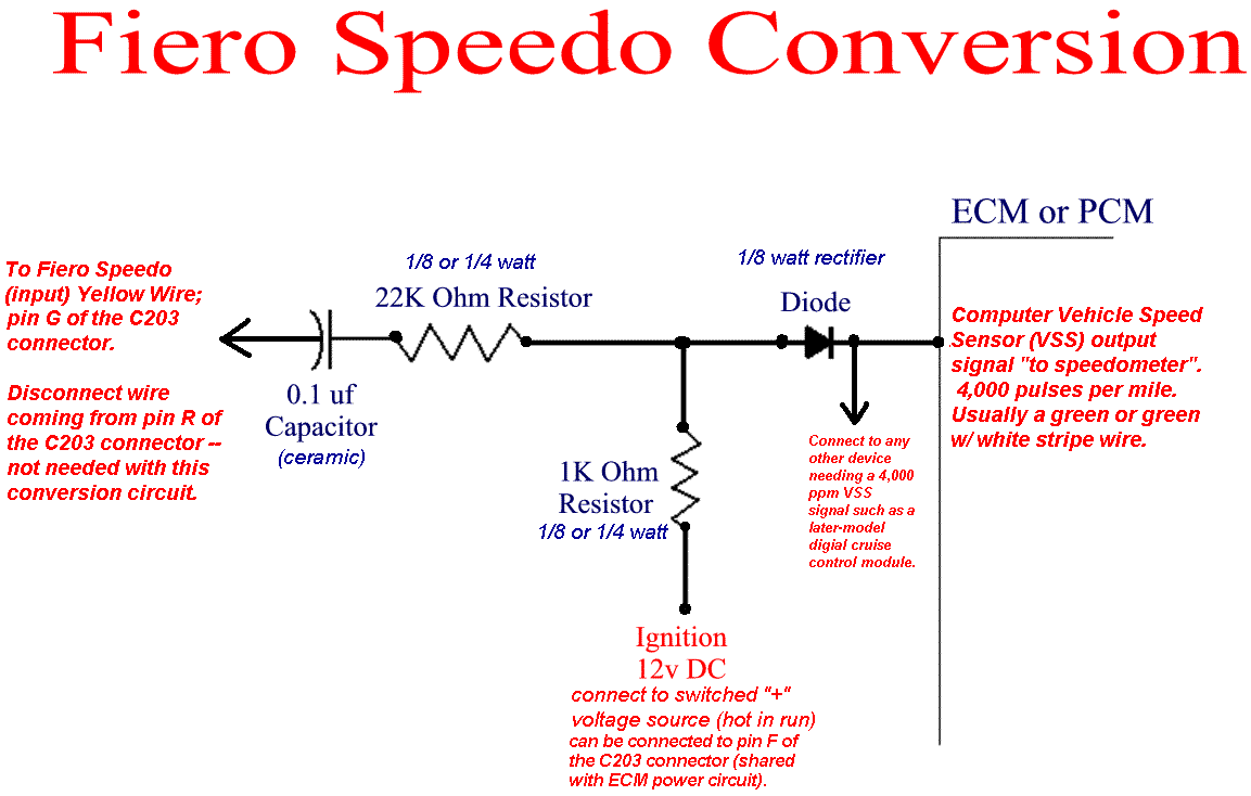

Bug 1: the tach and speedo are off, like i knew they
would be, but my question is for the tach do i just
bypass the filter or get a different one? and for the
speedo how do i hook it up?? i have the two wires from
vss going to the computer and then i have the 4000ppm ecm
output going through the converter and then to the yellow
speedo wire on the 203 connector, and i have the
purple/white 203 wire grounded. i though this was it but
the speedo registers about 5kph when im going 30 and
10kph when im going 40 45. what did i do wrong?

Tach: Playing with the tach filter will acheive nothing. Read this:
http://www.westcoastfieros.com/forum/forum_posts.asp?TID=180 2&KW=cfoss
My 1227730 speedo connection is like this and works well. It may work for your application as well:
As for the rest of it, I'm not much help. For bug4, look for a vaccuum leak, or clogged iac valve, that sort of thing. It could be the cam. Most try going a bit richer and advance the timing a couple of degrees to smooth it out.
