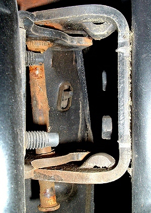

I was taking a look at my driver's door hinges to see what I might do to get ready for changing the hinge bushings at this Saturday's tech session. I've been struggling with this door since I bought the GT a year ago. The driver's door sags so much that when I'm closing the door it scrapes across the top of the rocker panel and has made a heck of a mess of it.
Have a look at the picture of my driver's door upper hinge. What do you see?
Yep, the hinge pin has slipped down because the flimsy little clip which is supposed to hold it in place has disintegrated. I temporarily just pushed the hinge pin back into place and the door closes PERFECTLY now.
So all this time it was just a one minute job to stick a new pin in there.
Anyway, I have the new hinge pins and bushings and I'm going to install them this Saturday whether the door needs them or not.
Post Options Post Options   Quote Capt Fiero Quote  Post ReplyReply Direct Link To This Post Posted: 26 May 2009 at 5:37pm
Yep I have had many of those type of moments.   As a side note as far as I know, there is no clip.  Its just a press fit.  Tapped in with a hammer and friction fit.
Post Options Post Options   Quote Dr.Fiero Quote  Post ReplyReply Direct Link To This Post Posted: 26 May 2009 at 6:09pm

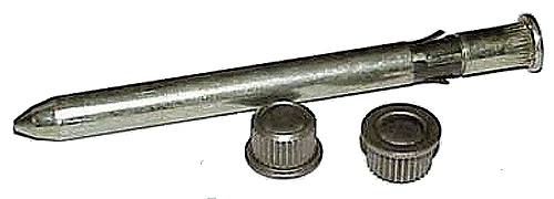

There is a clip - it's a "one way trip clip" (c) that compresses as it goes in, then pops out.  You have to more or less destroy them to get them out.  If they're old, they kindly shatter as you pry them out.  If they're newer, they're just a massive PITA since they're made out of spring steel (not to be confused with springsteen).
Post Options Post Options   Quote Patrick Quote  Post ReplyReply Direct Link To This Post Posted: 27 May 2009 at 1:05am
Yes, you can see the barbs on the clip in this image taken originally from Rodney Dickman's site.

John when we did that run of door pins several years ago at a tech session at your place using the Blazer door pins you ground down, I don't recall those having any clips?  If they were there, they sure did not work that well, as inside of a year the pins in my 85GT started dropping, A quick dab of JB Weld on the inside of the flat end and then a tap back into place, let it sit over night and was perfect from then on out.
