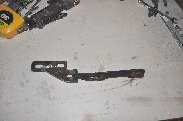

Haven't been here for a while so thought I would
update the build log.
I tried to set up my sail panel louvers to have a gas
door 6 louvers up from the back edge. I found that I
could get the gas door to open up with my hinge set-up
but i ended up with interference issues with the front
louver of the gas door. I wanted to see if I could do
the gas door but oem Ferrari is opening the full
louver panel so I am most likely gong to go that way
in the end. The smaller gas door looked really good
though.....
I am now on to the targa top latching mechanisms. I
decided to go with the same set-up that is on the
older Firebird and Camaro t-top cars. There are pins
front and back that slide into receivers on the inner
roof side and clamp the top down on to the seals. I
am using Firebird t-top seals so the set-up will work
on my application as well.
I made four latches front and back as I found that the
Fiero roof section that is now the targa was a bit
flexible and would not clamp down on to the rubber
seal very well with just two latches each side. I
have the latch sliders and pins built and attached to
the targa and this week I am building the receivers to
accept the pins. Should be pretty much weather proof
by the end of the coming weekend. The targa will get
convertible material glued to the outside and a
fiberglass inner shell made and covered with head
liner material to finish it all off and cover the
mechanisms but still have everything accessible..
I am still not 100% happy with the lever mechanism as
it offsets the pulling on the pins quite a bit as the
lever is rotated. I may go with the same mechanism as
the Firebird where there are two cams that intertwine
and pull the pins back. More design to be done on
that aspect before I finish off the levers.
Then back to finishing off the interior wiring and
install the interior and windshield and I am pretty
much close to having this bad boy on the road.....
Enjoy
Don

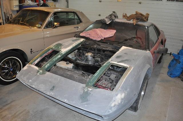

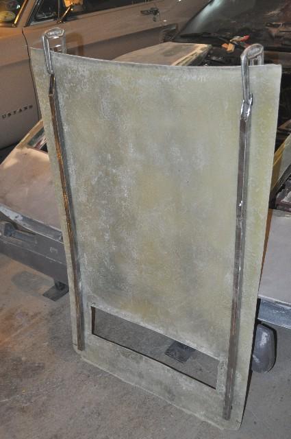

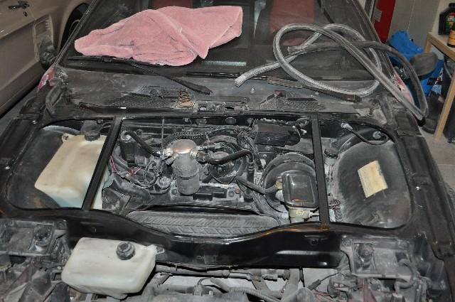

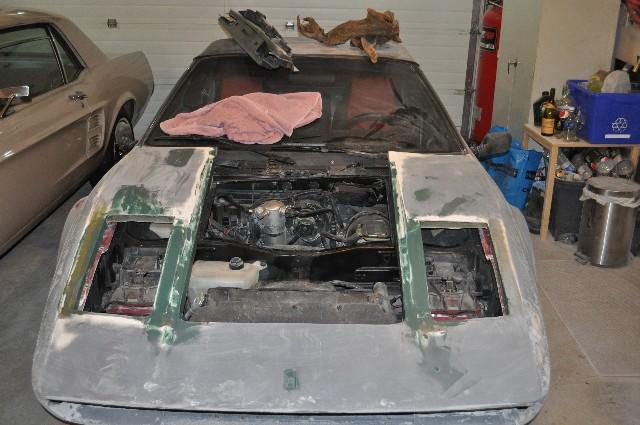

Not too many updates lately.  Other projects and yard work.
Headlights have been molded.  I need new fascias as the ones we used got ruined in the moding process.  Just as well.  We corrected a couple items when we molded anyway.
I have since been working on finishing the items list on the front clip.  vents, lights, etc. etc.  I found a new process I did not know about.  Low temp soldering of aluminum.  What a cool process.
I made the trunk vents out of metal and made a mess of the welding so I think I will redo the same vents in aluminum.  I also redid the front grill with the low temp soldering.  Again cool process and very clean.
I also placed my windscreen in for front fender fitting etc.  Really makes a difference for the look of the car.

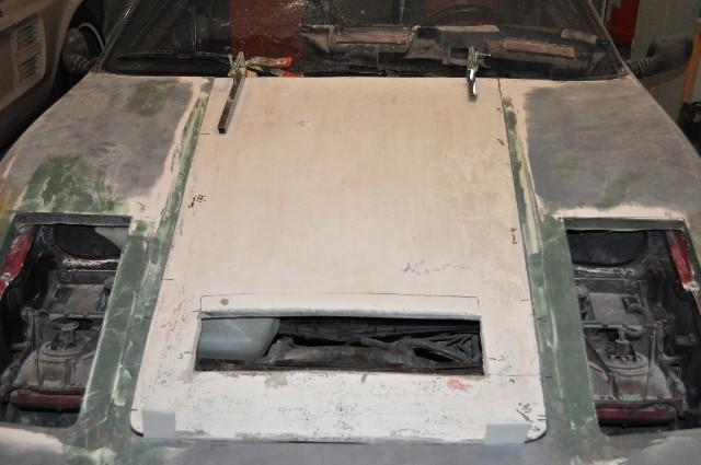

I saw Johnny is updating the build thread areas so thought I better contribute as well.,  I am finally back at the car again and making the final push.... again....
I went through some carbon fiber tries a couple weeks ago and totally messed it up so had to sand everything back off and I am waiting to get the nerve back up to try again....
I needed to redo the headlight buckets as they weren't working for me.  I made some jigs to get pivot placement and then tore the old Fiero headlight mount out and closed the bucket in to make a full and solid bucket.  Much better arrangement to start with.  I then made up some metal pivots similar to how I did the 355 buckets a few years ago.  Worked out well on the passenger side and now I need to get after the driver's side over the next couple days.
Don
Ready for the eye surgery......
Old bucket internals.  I had tried some expanding foam and it never set past a desert topping consistency so that put me over the edge to start it all over properly.
I closed in the buckets and redid the front fascias so they fit better on the new rearranged buckets.
Next was the pivot design and build.  The long ends out past the pivot will be bent over to be used as the open stop.
Passenger side installed in the car up and closed.
Rinse and repeat for the driver's side over the rest of the week.
