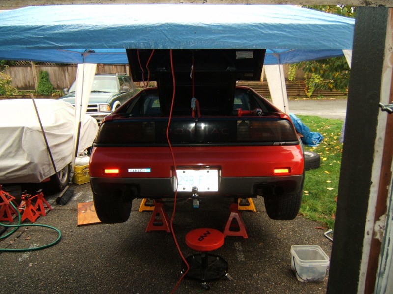

    We just got Nigel’s trans out of the car and the clutch fork is destroyed we need a new one quick.   We found one on the Fiero Store for $50 NEW, but we would have to wait, hoping that someone has one or knows where to get one locally.
  Please Call Nigel at 778-895-3691
Thanks
David
{edit} -- replacement transmission found.  No more calls required!  Thanks.

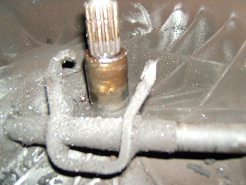

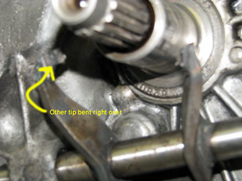

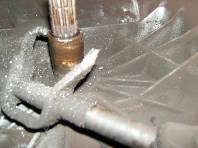

Dave is going to post pics of nigels fork later, but here's another one that I ran into that will probably look similar (excuse the focus).

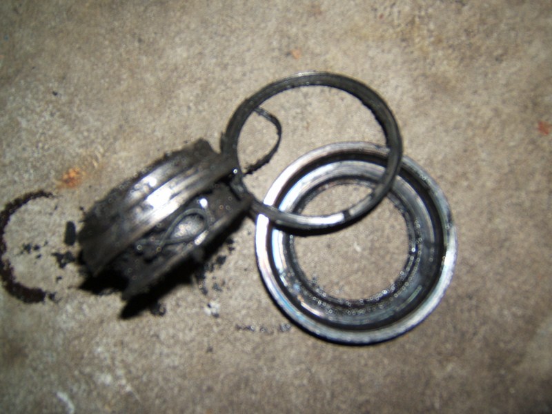

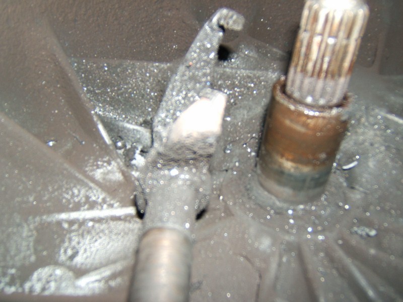

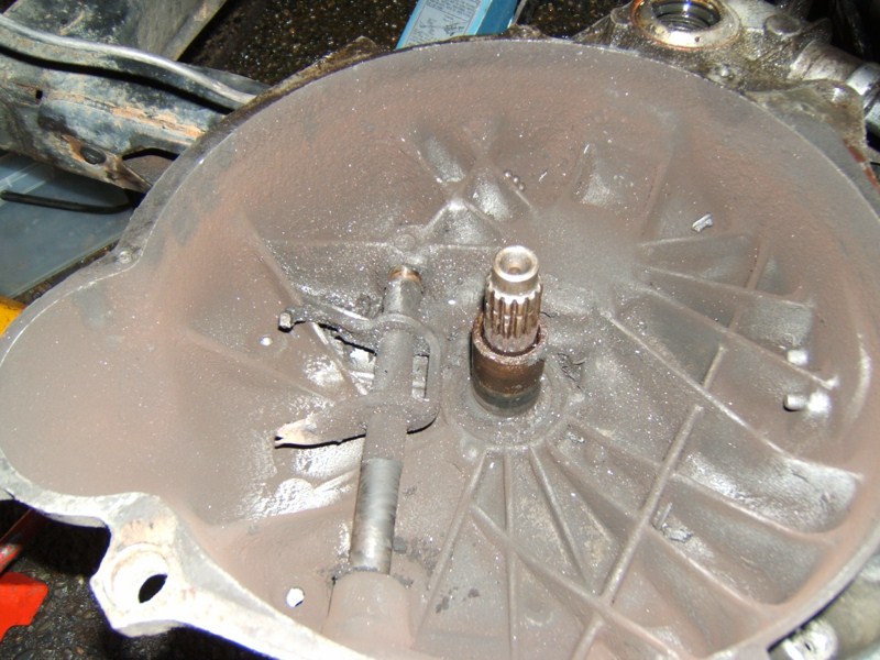

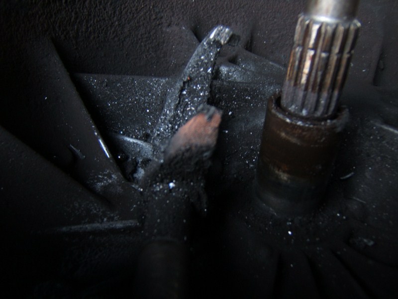

Here are pictures showing problems with my transmission.

ouch! could be just blown release brg, also may be just bad bearing or could be made bad by riding with the foot on the clutch pedal
Post Options Post Options   Quote Dr.Fiero Quote  Post ReplyReply Direct Link To This Post Posted: 18 October 2009 at 9:55pm
It pretty much comes down to a slightly crappy design.  They're made out of simple bent steel parts, welded together.  The ends fatigue and snap (after bending a bit) then all hell breaks loose.
That's gotta be the 6th one I've seen do that.
Post Options Post Options   Quote Capt Fiero Quote  Post ReplyReply Direct Link To This Post Posted: 18 October 2009 at 10:01pm
Yep, we suspect the clutch fork was bent previous, as the last shop, called and said it was bent, or damaged, then when we supplied the replacement part,  they claimed that magically it was fine.  (also told they could not figure out how to get it out)  Well they claimed to have fixed it and returned it to Nigel.  $2400 later and 18 months everything explodes apart, I finally take the time to look at it myself and find this nasty mess.
Looks like the fork failed, which took out the throwout bearing, which destroyed the pressure plate, which cost him the entire clutch.  At this point, we are going to swap in a complete new clutch and a complete new trans. (used trans)    No recourse from the shop as they only give a 1 year warranty.
        Ah well, I should have his car back together in a few days.

Not that I can tell aside from some gouges in on the sleeve the release bearing sits on.   Which I am sure could be polished out and the grease would fill up the divots.
          However seeing the bent master cylinder rod, I honestly believe they KNEW the clutch fork was toast and after getting it together and finding out that it would not release with the fork that bad, they grabbed a wrong clutch Master rod, that was too long, bent it so it would work just enough to get the car to function.  Just pisses me off to see a shop do that kind of crap/used car salesman tactic to get it out the door.    Unfortunately, its not the first and I doubt it will be the last time I get brought a car that a "so called" professional shop, has f-d over a Fiero owner.    Trust me I am the furthest from a professional shop as you can get, I just happen to know how to work on Fieros.  So occasionally, when I have some extra time, and need some extra cash, and am not working on my own Fiero's, I'll take on a job every now and again.    The worst cheats/scams/screw jobs all seem to be in relation to clutches.
