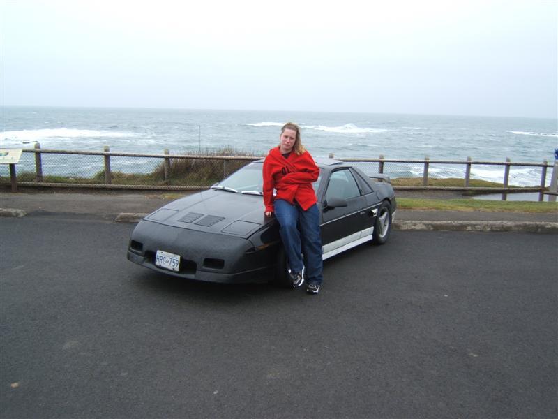

Post Options Quote Reply Posted: 25 April 2008 at 12:06pm |
Unless you are putting the car on a track the spare front sway bar mounted to the back is the way to go.
As for the short shifter, talk to Blair on these forums and for about 1/2 the price of Rodney he can do one for you. Plus shipping should be a great deal less. The front end looseness is exactly what you expect, and I would highly recommend front vents. Even if you do the simple Turbo Sunbird vents like I have on my 85GT. Install is a piece of cake. I was having issues with the headlight doors popping over at speeds between 160kph and 200kph. With the vents, I was able to sustain 180 without issue and only when going over 200 and hitting a slight head wind gust did I have the doors come open on me. This also aided in cooling of the radiator as the hot air has a much easier path to escape from the radiator. |
